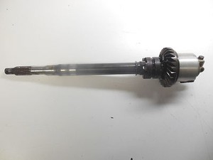

Get yourself a FACTORY manual before you damage something $$$$$$ This is what it will look like once removed..
