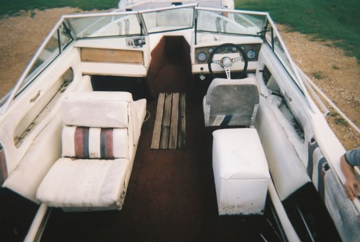

Here's another one of some of the interior before I started ripping it out. I didn't get any while it was still full of leaves and I have already removed the engine cover and rear seats.

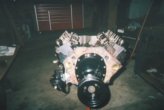

There is a very long and boring story about the engine, but the end result is that it I had to do a complete rebuild, the starter was bad, alternator was shot, and the fuel pump was junk.
Here it is not long before we set it in. I didn't realize the fuel pump, alternator, and starter were bad until I set it in the boat. I had already installed a new starter, but it was the wrong one. It wouldn't touch the flywheel.

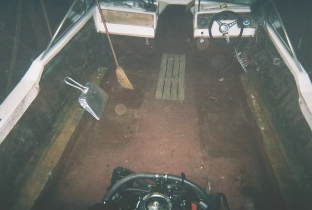

Feeling confident that the engine and outdrive are OK I decided it was time to tackle the interior and the carpet.
Got the carpet out now and I realized that the pieces that hold the dash up are rotten, thus letting the consoles fall down and not letting the window shut correctly.
