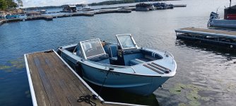

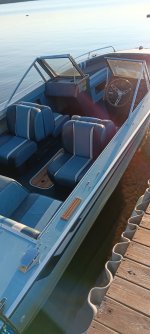

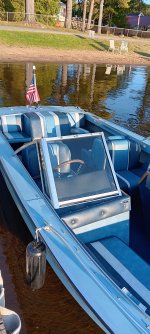

So I bought the boat last year. It's an 18' aluminum with a 2.5l I/O mercruiser. Runs fine and is mechanically sound. Started with a 17p prop and I could get it to 4k RPM. If I trim any higher it starts porpoising. Tag on the motor says WOT is 3900- 4300 rpm, but I read that the spec was changed that same year to 4200- 4600 rpm, so I figured I drop to a 15p. That made it worse. At WOT it's porpoising at about 3600 as I trim up. Should I try the opposite and go up to a 19p? I can live with a max of 4,000 but I also don't want to lug the motor. Thoughts anyone? P.S. the boat has not been modified an any way and it's just me in it when I run the tests. Both props I used were aluminum, also there is no rot or waterlogged wood. Thank you.

After it settles I am running around 3500- 3600 at WOT with a 15p. With a 17p I could go 4000. You're saying to keep the 15p and add weight in the front? Starcraft put everything in the back. Gas tank, battery. I've considered routing the battery to the front.

Rpm numbers don't add up because the boat will porpoise before I can trim all the way. As you and Scott mentioned I think I'm in a good place with the 15p prop, just a matter of pushing the front end down. Blue fin had a similar hull with an I/O and they put the gas tank in the front. I scratched my head over that but I think I know why they did it now... if I want out on longer trips more often I would just put a cooler up front, but I think I will relocate the battery for a more permanent solution. I thought about smart tabs but I really don't think that's necessary on an 18' aluminum runabout
