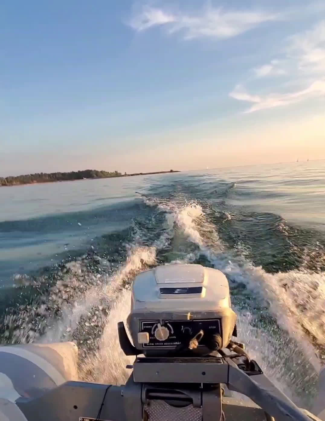

Here is a video going top speed:
Seems slow right?
In comparison my 76 Evinrude :
Revs higher right? Seems faster right?
How do I make my 1985 Yamaha rev higher, and go faster than my 1976 Evinrude ?

Ya could put the Yamaha in your truck and probably get her up to 70 or 80 mph
I'm not sure you're gonna be able to beat your Evinrude. Not cuz I think one is "better" than the other but because they are entirely different engines and 9.9 hp rating does not translate very easily into lbs of thrust. That being said, I support your effort to try to improve performance.

My Evinrude has the 9.9 carb, but he did swap the flywheel and converted it to from points & condensers to CDI . Does it make a big difference? What's the advantage ?
I also have a 15 Evinrude which goes a bit faster than the 9.9 Evinrude, but uses the older points and condensers.

That Yammy if set up correctly will perform better all around the Junkrude
