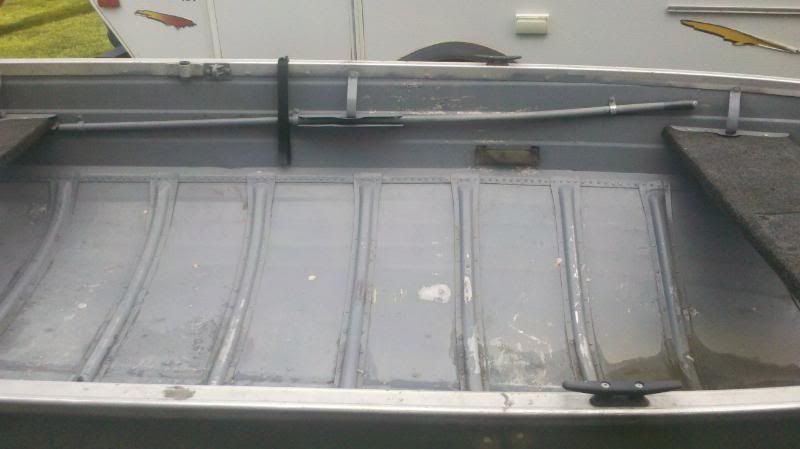

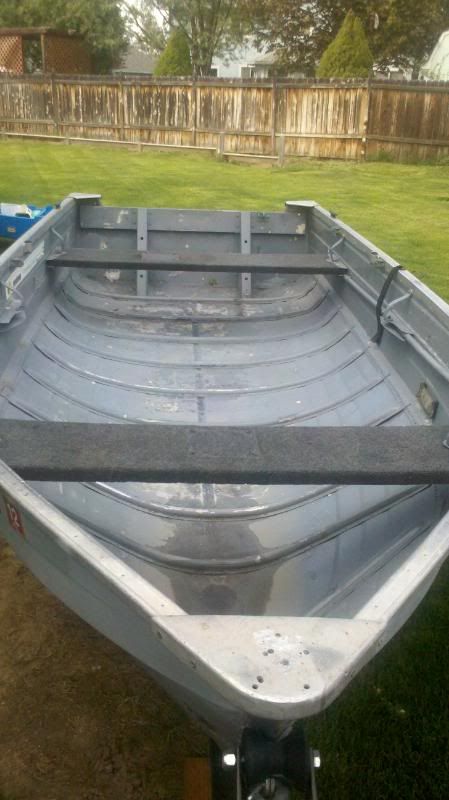

Purchased a 12' MirroCraft with a 1989 15hp motor, of which I am in the process of restoring...First a few pics.
The trailer this is sitting on has been replaced with another that I had refinished a couple of years ago. Old trailer has been sold.

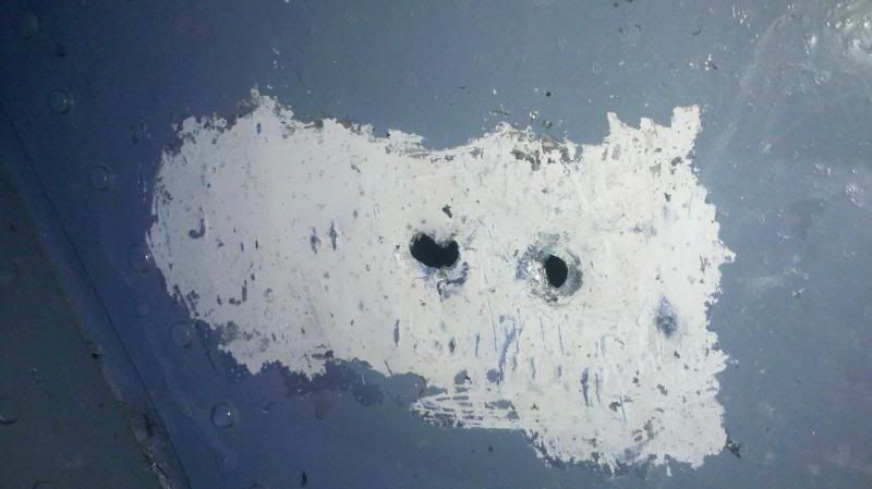

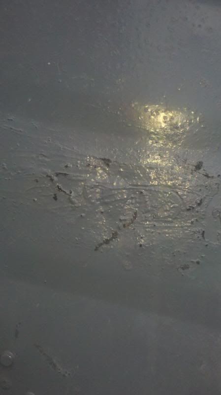

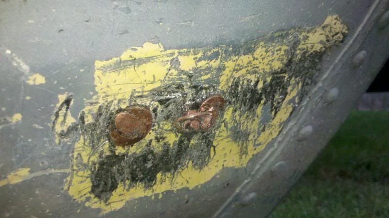

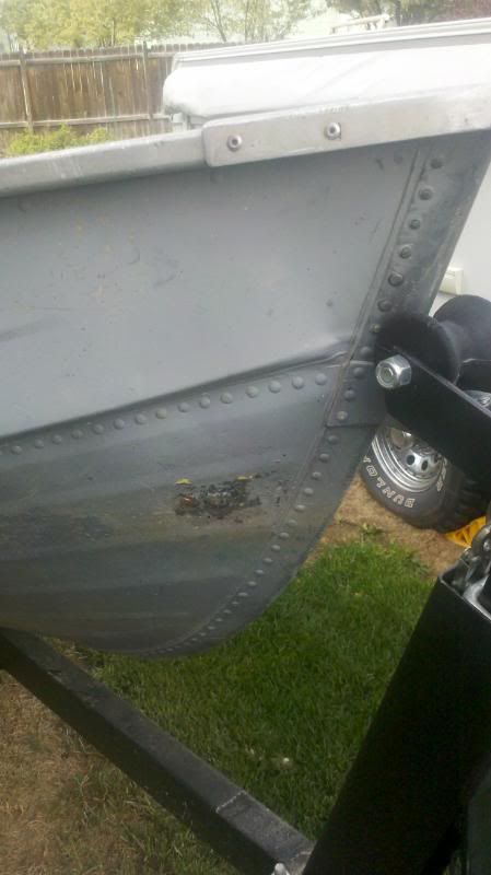

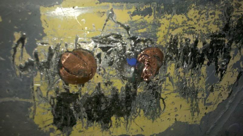

I have since removed some of the components that the PO added. Upon further inspection of the bow I noticed what may be a problem, and I am not sure what to do. Looks like there may have been two punctured holes.:eek: It has been filled with some sort of copper plugs then siliconed around both inside and out then painted over.
This is the outside
from the inside
Should I leave it or have it welded??? I am planning on repainting the boat

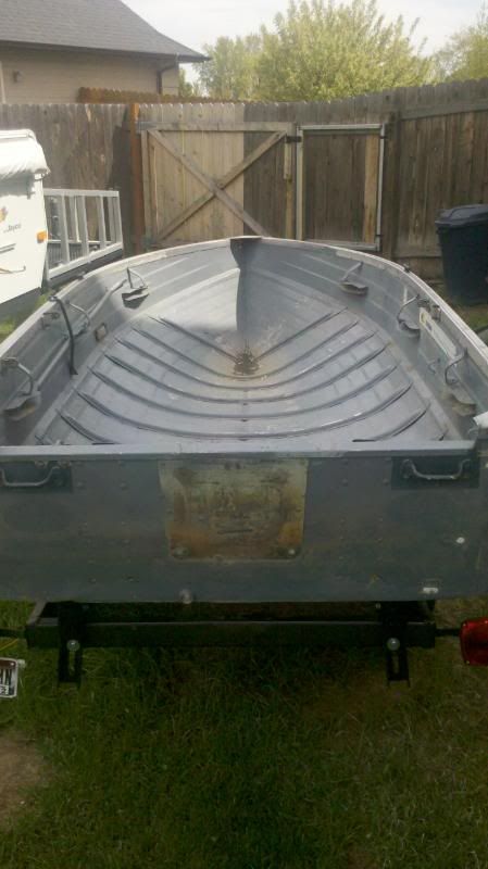

Here is another shot from the bow...

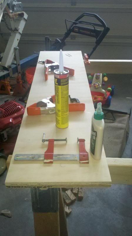

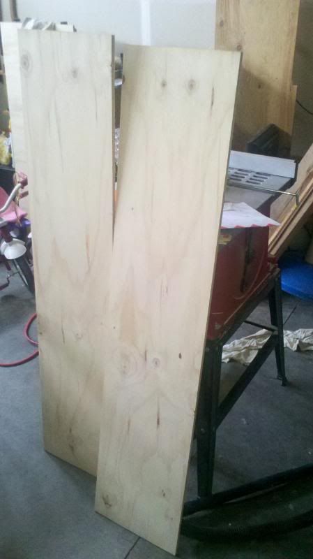

Finished ripping out the seats. Cut new seats from 1/2 Ply and glued pieces together to make just under 1" thickness. I'll be using 4-5 coats of Spar Urethane to finish the seats.

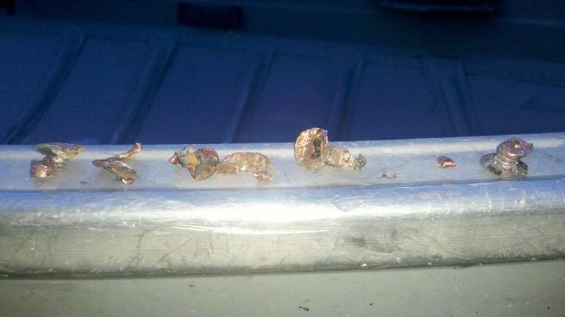

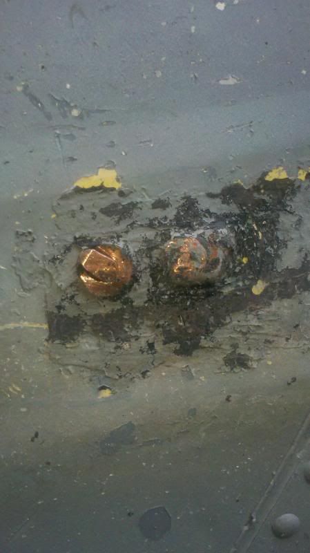

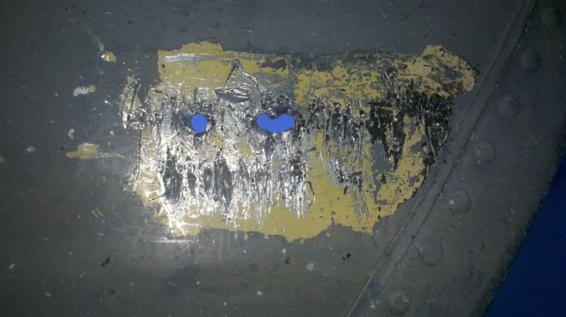

Spent some time cleaning the area that had the copper "plugs". Once I began cleaning, I found that it was a little worse around the plugs than I had thought.
I then decided to pull the copper out. The holes were smaller than I had thought. The copper plugs turned out to be some sort of rivet.
Continued...

Here it is without the copper rivets.
From the inside - You will see the larger hole has a crack at the bottom.

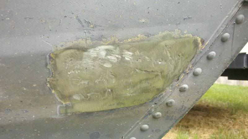

After pulling the rivets and cleaning it up I decided I should have it welded up. I called a welder I have used in the past, and for $50 it came out like this. I was very pleased.

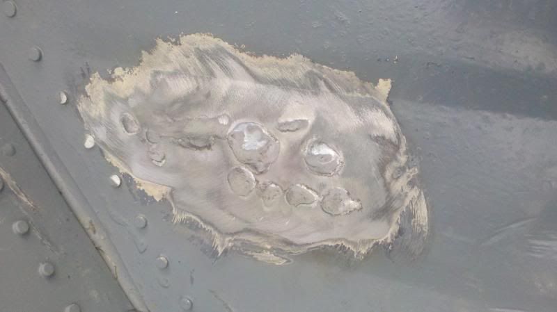

Most of the rash below the holes was paper thin, and he was able to build it back up. Here is a pic from the inside.
Anyone know of a good aluminum filler for the gaps (low spots/nicks) in the aluminum? Next up is the removal of the peeling paint, and scuffing on the good paint. Picked up some paint supplies.

Looking good.
KUDOs on getting it welded. Smart move!!
For a filler on an aluminum boat...... JB weld ;)
Hint..... under your plywood seats you can install some aluminum angle and it will stiffen the new seats significantly. Makes them easier to step on.

I'll have floatation installed under the seats. Thanks for the heads up. I'll use the aluminum angle to make the seats more rigid, and also to attach a front and back wood panel to "hide" the floatation
