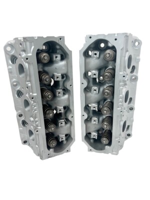

Would you happen to have more info on those edelbrock manifolds and vortec heads?
Would this qualify for the head?:

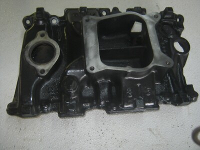

How about this for the manifold?

Those are Vortec heads but they are bare heads no valves installed.

But the manifold is for the old style heads. Vortec uses only 8 bolts for the intake but pre Vortec uses 12.
That manifold while it is for your heads, may not work on the OMC you have because the stat housing is shifted to the port side & might interfere with the high mounted alternator that OMC used.
If I were you I’d just get a GM cast iron Pre Vortec (12 bolt) 4bbl intake off of eBay and get an Edelbrock 1409 or a Holley 4160 with the side mount fuel line (that will clear the stat housing). You may have to do some fabbing with fuel lines & throttle cable but the 4 bbl is 100% worth it IMO…..

Here is a set of GM 4.3 vortec heads fully assembled
