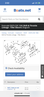

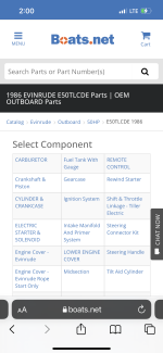

Im located in Louisiana, but I've been through every evinrude/johnson parts dealer website but this is what im seeing, they all have the shift and throttle linkage for tiller electric motors which look completely different.. i wish i knew the part numbers and im not exactly sure how to find them as of right now..

This is all i can find on any website

So is your motor a tiller motor ?-----Pictures show a remote motor.----------Been converted to remote ?------You totally looking this up wrong.----go to ----evinrudeparts.ca-----And find the part numbers for this motor !!-----Look on the cylinder / crankcase page.

Did that and decided why not look through the other diagrams they have on that site and low and behold it was on the crankcase and cylinder diagram, hard to see and pick out. Should i put some lube grease on the old moving parts that I'll be putting back on? i do appreciate you my man! You'll probably see me with another dumb question when i go to tune the carbs lol
