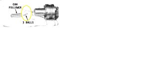

If they were round ball bearing about 3/16 dia these are prop shaft pin bearings.

At the front of the Propshaft, there is a Hole, that the shift plunger goes in to move the Clutch Dog. 3(I think) balls go in there to provide an antifriction friction surface for the Plunger when the Propshaft is spinning.
This is not the case for your engine but the Propshaft assembly is typical for Merc in that power range. #8 shows the ball bearings

This prop shaft does not have any bearings. I am suspect that they came from the shifting spline shaft or the drive shaft.
Sorry I was mistaken. I found where the 3 ball bearings go...lol
And yes, I found the roller bearing on the prop shaft. all bearings seem to be ok.
I have come to the conclusion that if I need to replace the roller bearing on the drive shaft I will have to take it to a shop. I do not see any issues with that bearing either. I guess Im going to put it back together with those 3 ball bearing in the proper place and see how things go.
