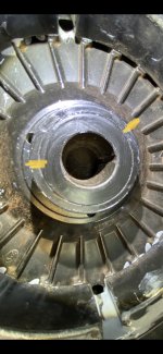

I reattached the magnets and I still have a problem. I am getting a backfire out of the exhaust. I’m thinking the trigger magnet moved a little and is causing the problem. I will attach some pics if anyone can give their advice. If this is the problem can it be fixed or do I replace the flywheel?

i would grab a new used one . i guess someone could chime in here and say its possible to take it off, clean and re-epoxy, but it needs to be in the exact right position for the sensor assembly to trip the powerpack switches at precisely the right moment. maybe OMC made a special tool at one point to re-set these.

would the 1988 - 92 crossflow be the same? I tried to move the magnet I wrapped it in leather and used a big pair of vice grips and it doesn’t move. I find it hard to believe it moved on its own. I have been searching the internet for a picture of my flywheel that shows the magnet but haven’t found anything that can be seen clearly to rule this out as the issue. It’s definitely firing out of time but not consistently. It fired up and sounded better but has an occasional pop through the exhaust and I am unable to bring the idle down without it stalling. If the magnet were the problem I would think it would be constant and constant. It’s either the magnet moved or the new CDI timer base is junk.
