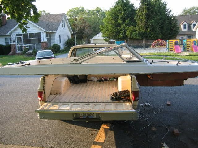

Oops, was wondering when you might chime in on this? Guess I have my answer now. Right now I only have myself and another guy, so the crane system will be the better idea. I have the wood, and its not going to take long to build it. With the pully system I got today, it was less than $20 in materials to be able to lift this without a whole lot of manpower. I also have to be able to set it down in a pickup, move it behind my house, and lift it out of the truck again. and I will be able to do this all again when I need to put it all back on. Wood was just sitting in the basement waiting on something to do with it anyhow. My little 12hp Craftsman tractor is going to be the muscle in this outfit. Pulley system will be hooked up to the rear of it, and we will use it to pull the cables. Most of the other parts were also laying around the house. So no major expense was laid out . Recycling :)

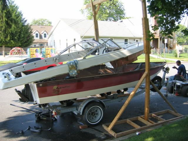

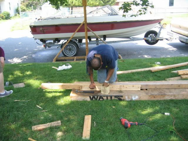

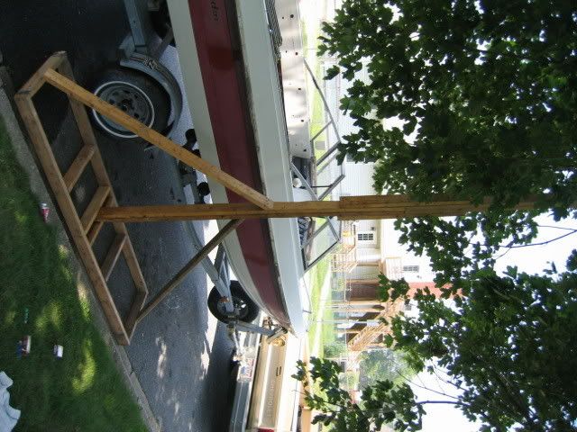

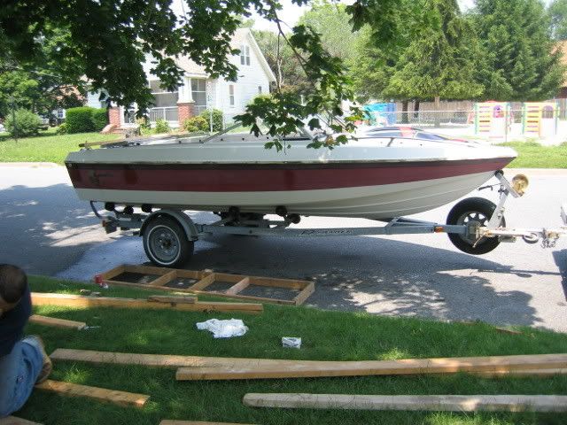

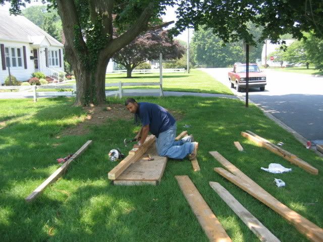

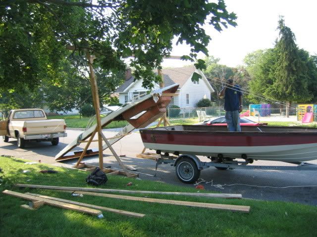

Day started with a bang, all the wood was brought out, we had the plan, all the hardware was ready. Just needed to start.
Off we go, posts are being constructed

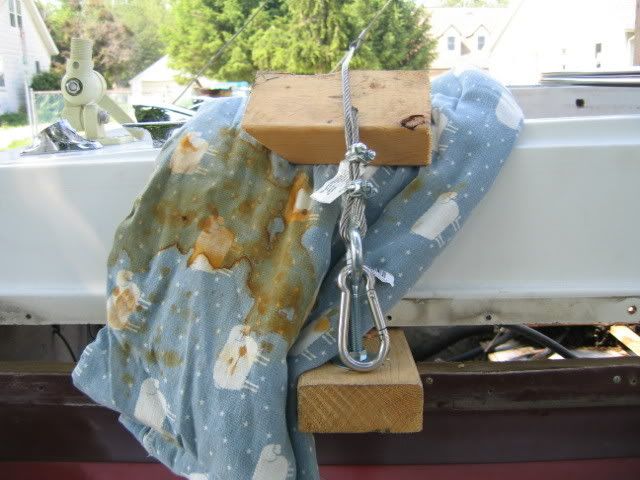

So we get the posts constructed, get everything setup. 2 pulleys, 3/16 wire rope, swedges, eye bolts, and get everything in place.

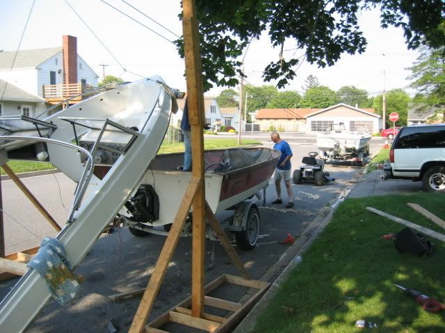

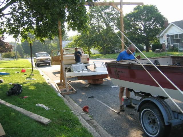

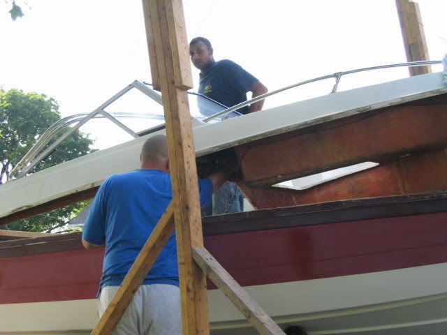

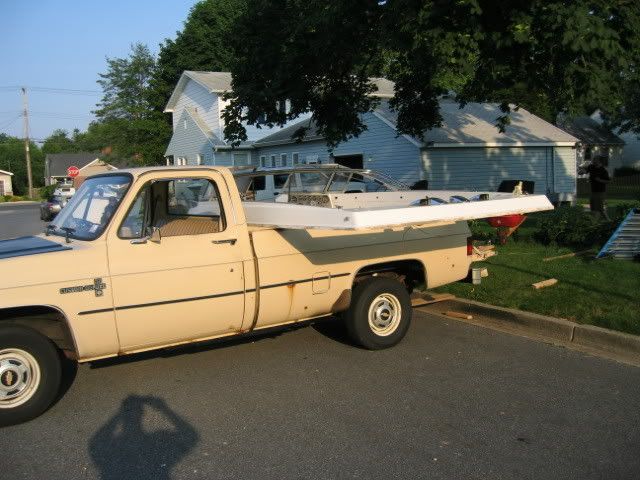

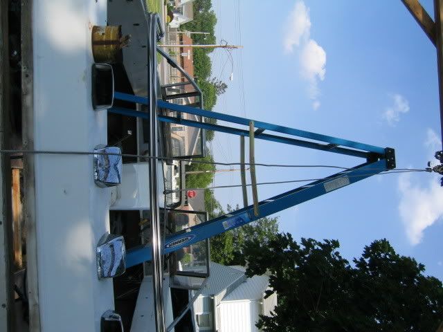

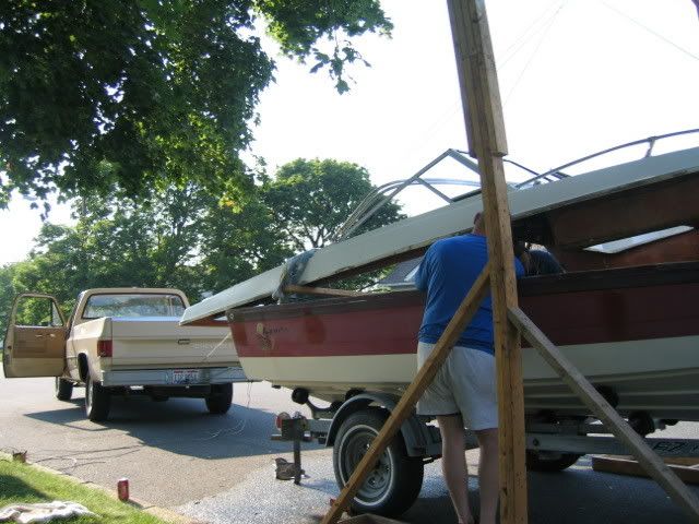

Hook up the garden tractor to the wire ropes, as soon as the cap gets 2" off the top, the entire thing shifts, we ended up moving the posts, moving the spreader bars, and readjusting the load about 5x, whomever said this thing could just be lifted off by 4 guys is nuts! with 3 and a pulley system we fought it for over 3 hrs. The garden tractor just did not have enough weight, so the truck was swapped in, problem was murphy started tipping the posts over. So we had to tie off the top of the A frame to my 2500 suburban, just to get the cap as high as you see in the pictures.

Well there you go, from start to finish, just over 7 hrs with 3 guys. I will be planning a whole different scheme to put this thing back on, to include more manpower, and a lot less heat!!! Delaware had one of those record breaking heat waves today, Temp was over 90? and with the heat index, it was close to 100? today. So there is some reason as to why the job took so long, I think I lost close to 7-9 lbs in water weight today.

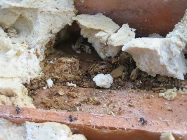

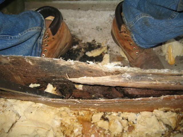

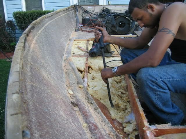

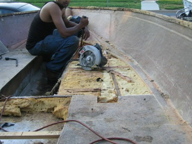

So this evening after getting through the 3rd day in a row with 95? temperatures, we got to work on the boat. I only cut a small section out, as I did not want to get it too weak before I was ready to take measurements.

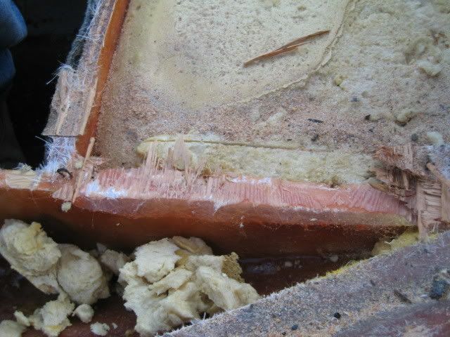

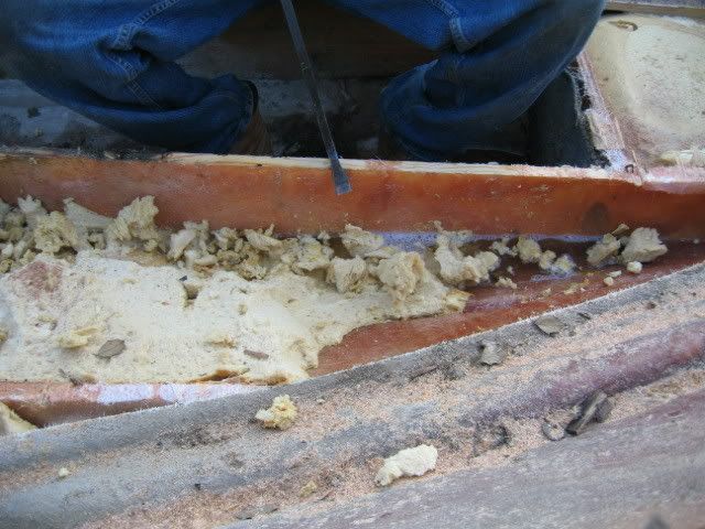

You never know what you are going to find when you open something like this up, what I found was pine boards, not plywood used for the stringers. The floor looked to be actual marine grade, but I am not sure how they constructed it, but in the front section we found wet fiberglass (tacky still) under the foam. The stringers were covered with a sheet, but it was never smoothed in. nor was it sealed. I believe most of this was a blown in mix, and done fairly hastily.
Not sure what this stuff was, found it between the hull and the foam in the front stringer box.
Well there you have it folks. I would not want to do this professionally thats for sure. This was about 2 hours worth of work, being done by 2 guys that do not even have a clue about what they are doing...

camel....how was it in there? it doesnt look too bad..?

Looks like the rear of the boat has the most damage. Landau just did not get the wood sealed well enough. I probably could have held off doing this for a season or 2, but since I was in there, figured we would go ahead and fix it now. I also am not too keen on the pine that is in there, would rather have something a little stronger on the floor.
