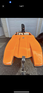

Currently fighting my Cougar Cub with a 25xd merc, having an issue with only getting spark on 1 cylinder and no fuel getting to carb. Will start and run on 1 cylinder while I spray gas directly into the carb. Really just need help finding the fuel pump/carb rebuild kit and what wires to ohm out to point towards bad coils, stator, switchpack etc. Seems almost impossible to find manuals/videos on these older motors.
