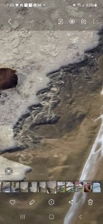

I dont really have to much history on the hull. It seems like the patch is fiberglass though.
