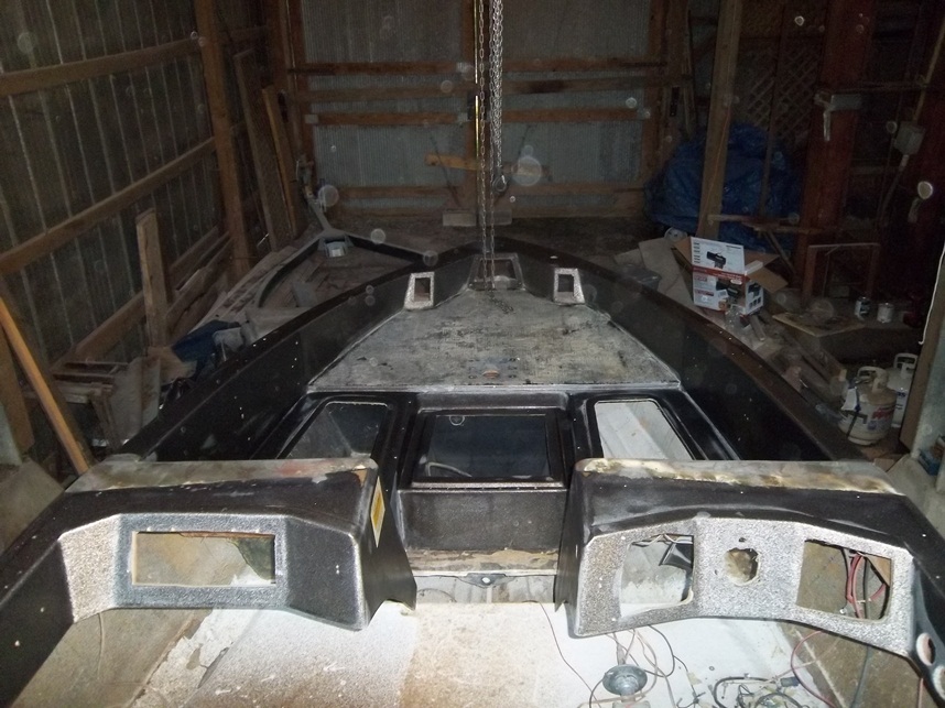

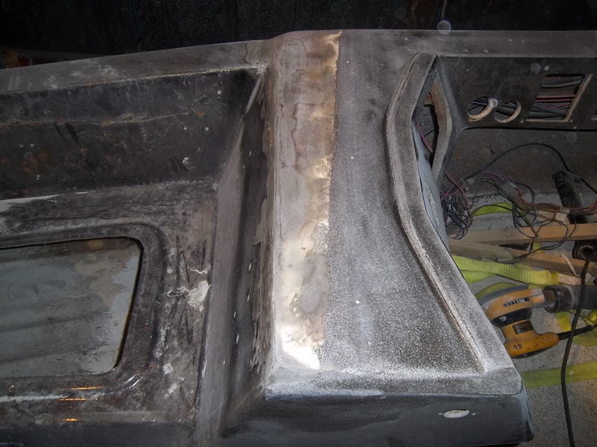

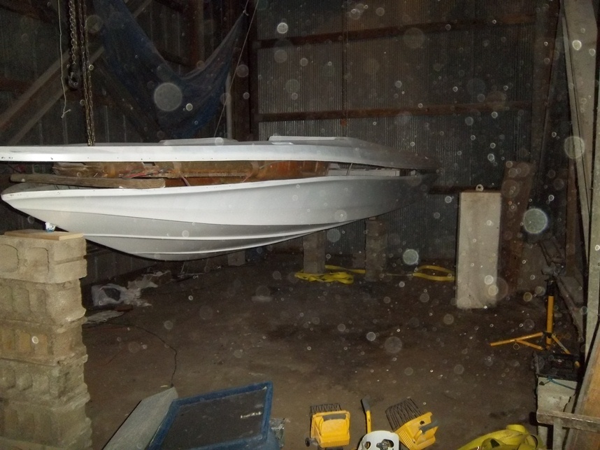

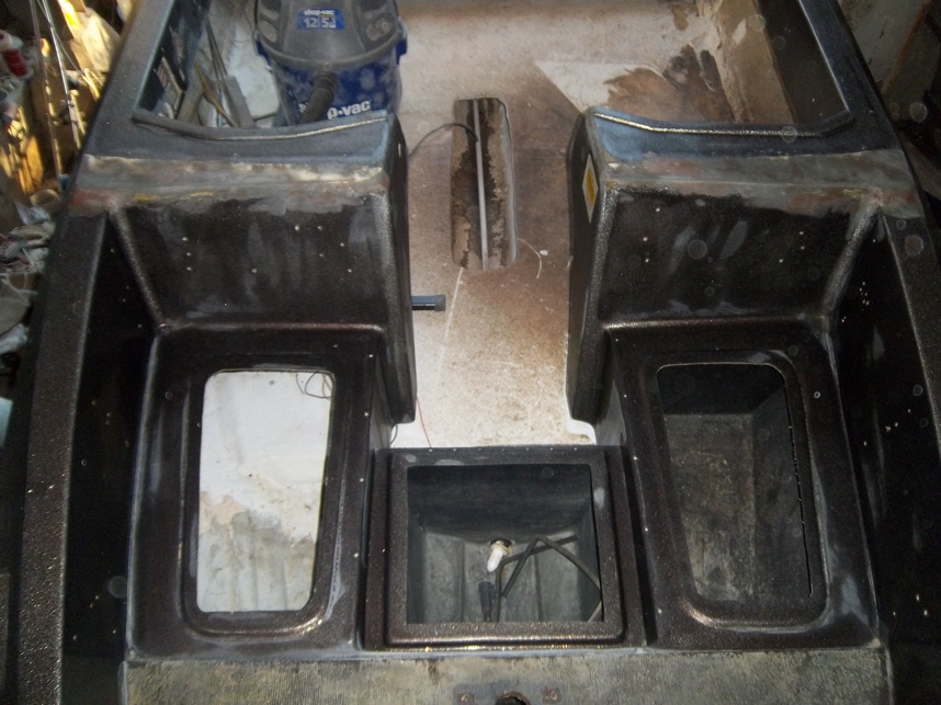

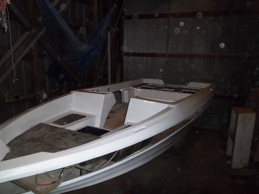

Finally some progress. I have 2 coats of Primekote on the bottom half and one coat on top half. Most the visible scratches have been filled and I will probably say good enough on that. Not having to fill, wait for it to dry, then sand should help things move along quicker. The plan for Sunday is get the top half sanded down and put the second coat of Primekote on. Wait for that to dry to the touch and start sanding the bottom and making sure I have everything needed to start applying the Perfection. I hope to be painting by early afternoon when it is the warmest. I would like to come back later and sand down the top half and put it's first coat of Perfection on as well. I only have Primekote on right now and it is already looking much better than it did before.
Here are some pictures.

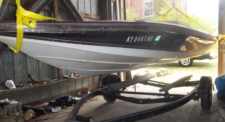

The hull that I started with.
After 2 coats of Primekote on the bottom and one coat on the top.

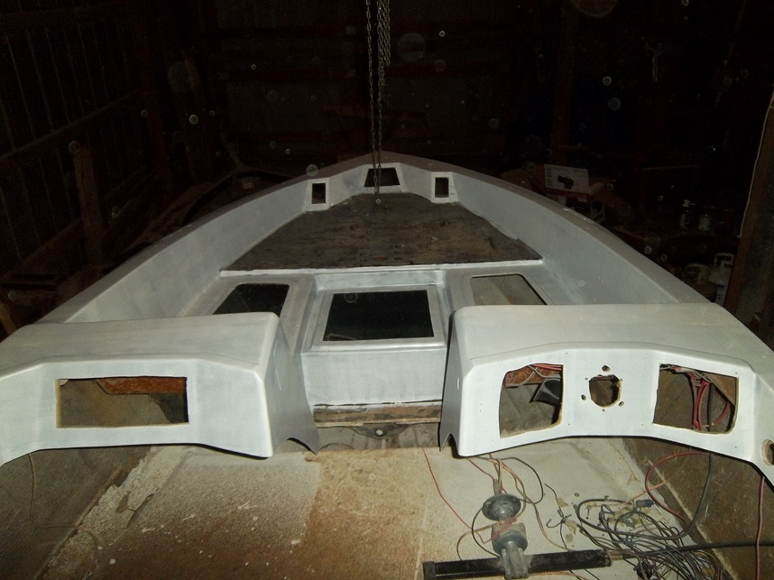

The front of the console before I extended it. You can see the outline of where the windshield used to be. I made the console level out all the way out to the cushion.
The extended console (from the opposite angle).

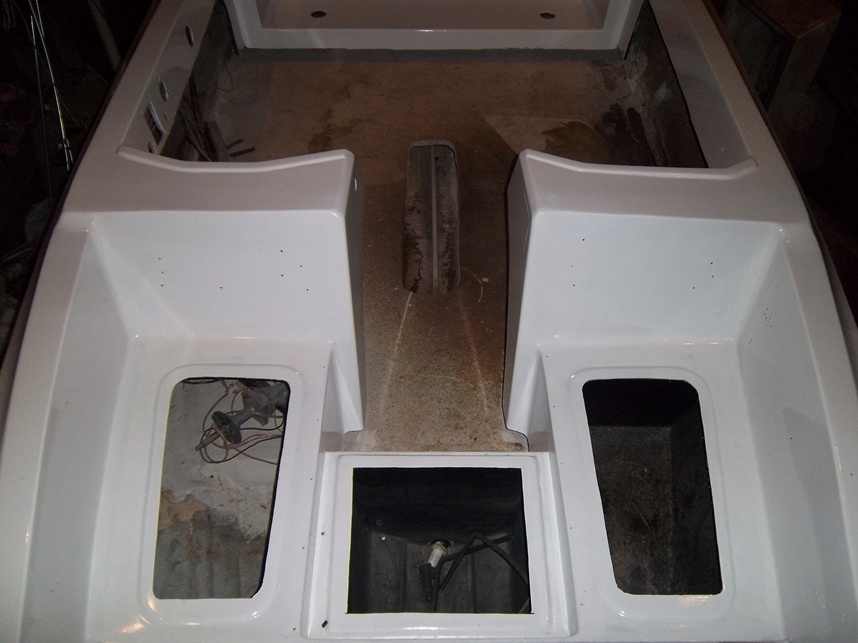

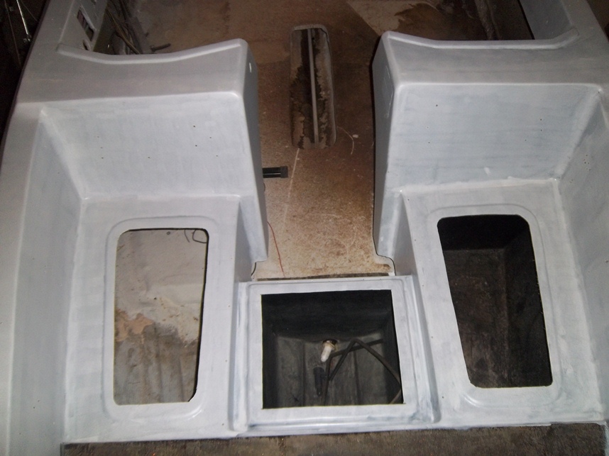

Both consoles extended.
Both consoles after one coat of Primekote.
Middle of the boat looking forward.
Middle of the boat looking forward after Primekote.

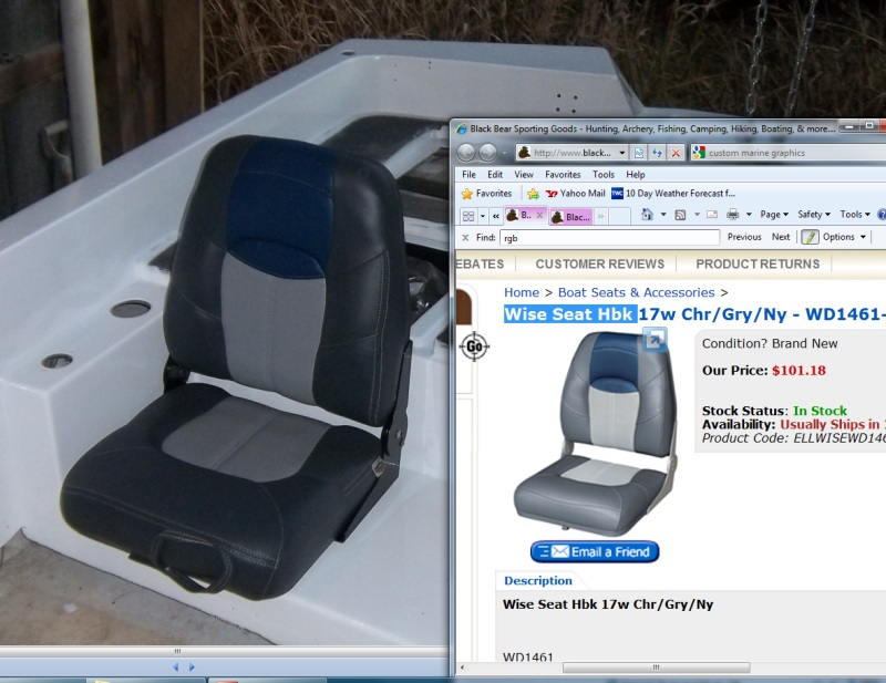

Here is an image of the Wise seat that I received compared to the image provided from the vendor and the manufacturer. The manufacture was very responsive when I told them I was looking for seats. After I sent them the picture and asked why the color is so different, not a peep. I decided I will return the seats and go with very light colored seat. I haven't found exactly what I'm looking for yet but one thing I know is that it will not be a Wise brand seat.

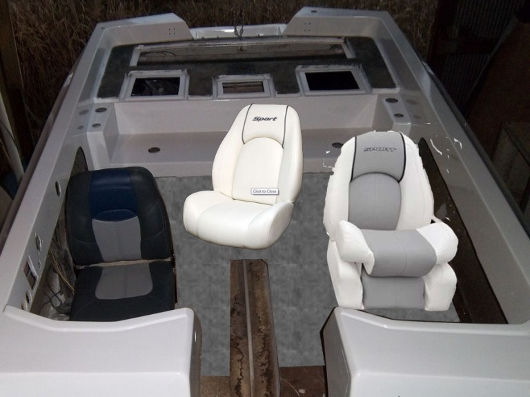

Please forgive my very bad photoshop. These are the types of seats that I'm looking at. They seem to work much better than the dark seats that arrived.

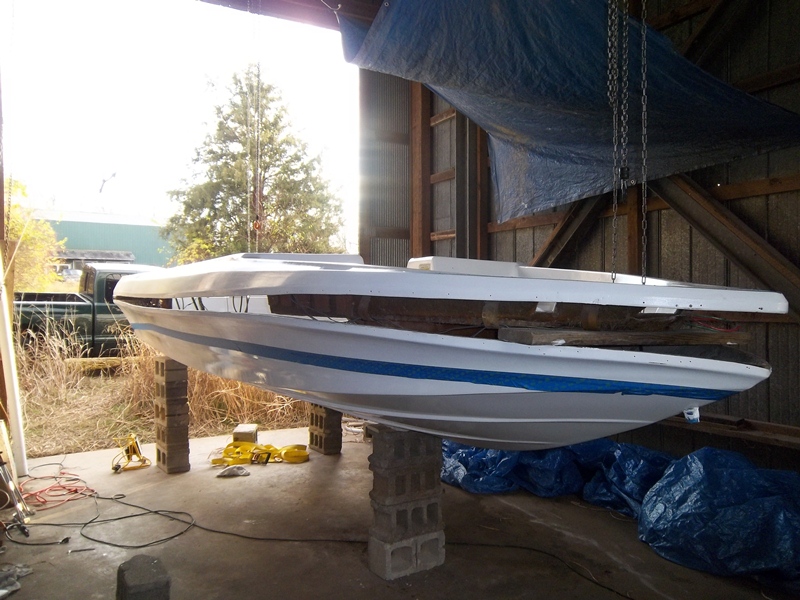

I finally got the stripes layed out and put the first coat of blue on. The blue masking tape is still on in the picture. Using a paint with color is a lot more difficult than with just white. Any little over lap and pressing too hard to too soft with the roller will show up. I also started work on sanding down the trailer. I should have plenty of paint left over to cover the trailer so that it will match the boat.

I have found that you cannot trust pictures on the web. So many variables can change the color that you see. I think they look pretty close if you asked me, just a little darker. The web picture just looks over exposed.

I think those are pretty nice looking seats. I have been pleased with the upholstery quality on both the low-end and high-end Wise seats that I've purchased.

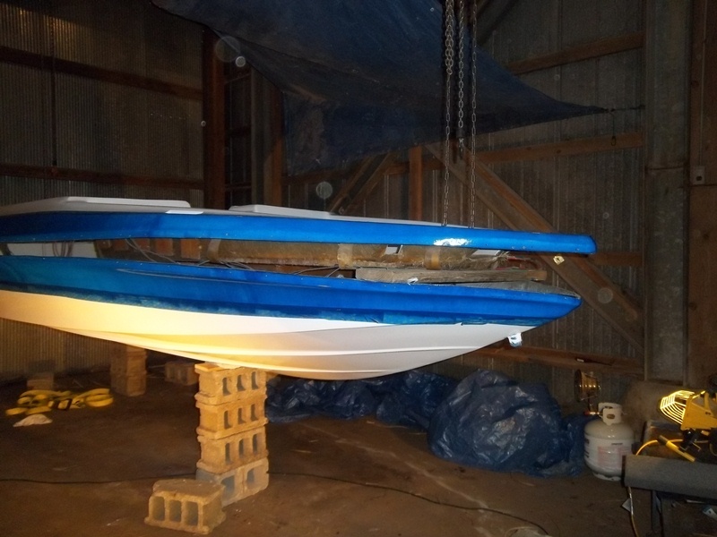

Second coat of blue paint went on last night. I still have noticable overlap marks but it is getting a lot better. I am hoping the 3rd coat will cover everything up and come out great. If not I will put on a fourth coat. That will probably leave me short for painting the trailer though. We've got rain and cold weather the next couple days so I won't be able to do any more painting until the weekend when it warms back up.
