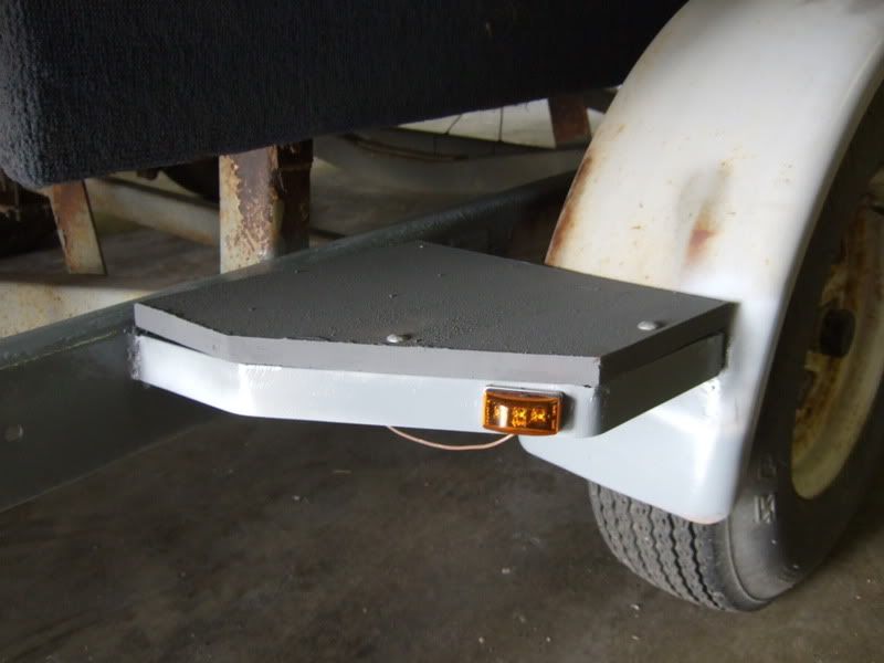

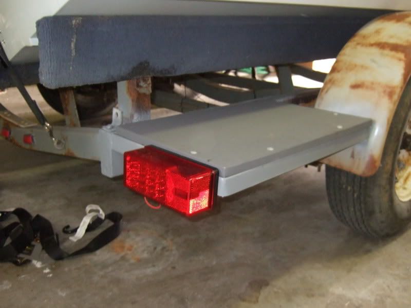

I have also done some work on the trailer: added new LED lights all around and rebuilts the steps in front of and behind the fenders. I will get photos when I have the trailer hooked up to see the lights.

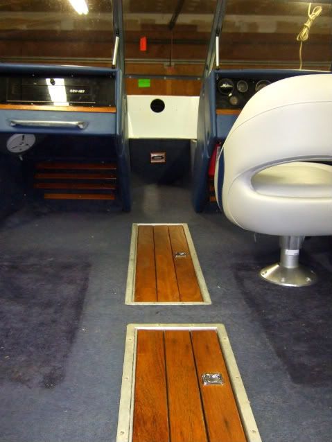

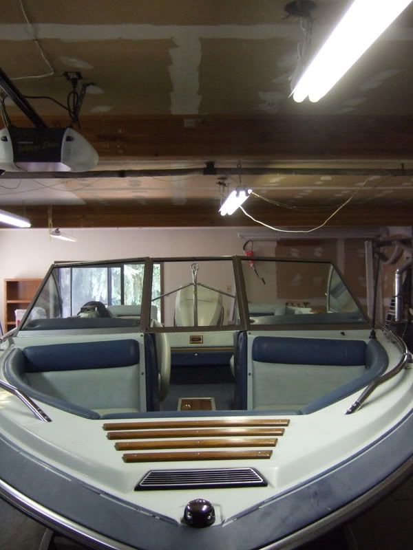

Bow teak installed and new 2 mile LED nav light
Storage lockers and new captains seat installed

New trailer steps installed, will finish bolting it down when the boat is in the water.
Front

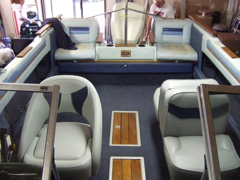

Bow cushions installed
New Back-to-back seat installed and ski bar

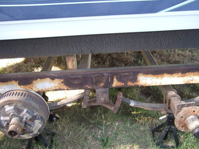

Here is what the trailer frame looked like behind the wheels
Here is what it lookes like after grinding, and 3 coats of paint & primer
The boat/trailer is originally from San Diego and spent the first 15 years of its life in the salt, which is why the trailer is/was so rusty.
