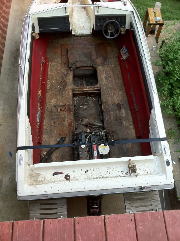

Hello, I am new to this forum, and found out about from friscoboater, and his youtube videos. I am looking at a very similar project. I inherited a boat form my father in law who past away several years ago. My brother in law had it for about 3 years and worked on it a bit. they decided to move so we drove form alabama to CT to pick it up. Getting the engine pulled this weekend, transom is shot, floor is shot, some stringers look OK, but cant tell until i remove the foam. One issue i have is that i it has a fiberglass tub in the forward section, attached to the CAP, i do not want to remove the CAP, anyone know if i can just cut it out? looks like the wood and carpet goes all the way under the "tub" in the front. Going to be a long road here but i always wanted to fix it up for him. Everyone thinks i am crazy and tells me a could buy a new boat cheeper. But to me i think it is worth it.

OK, got the engine out, it was not easy, the rear mounts were very hard to remove, they had to cut the head off the bolt and pull it out that way, the bolt is still in the gimbal housing.
I made a stand for the engine so i can move it around in the garage, it looks like it may need some serious work as well, the starter seams to be rusted through.
Got the Gimbal housing off, and tore out a good porting of the deck, when i pressed on the foam................water actually came out, surprisingly, some of the stingers may be intact. I will not know until all the foam is out.
here are some pictures, the transom is not even skinned except some tabbing on the deck, and there is not a lot of rot directly around the gimbal housing, the bulkheads look shot. I figure i will gut the boat, measure and cut wood during the winter, then glass in the spring when it warms up.
has anybody ever had a rear engine bolt seize in the gimbal housing.................i have used a 2 foot breaker bar to no avail.
