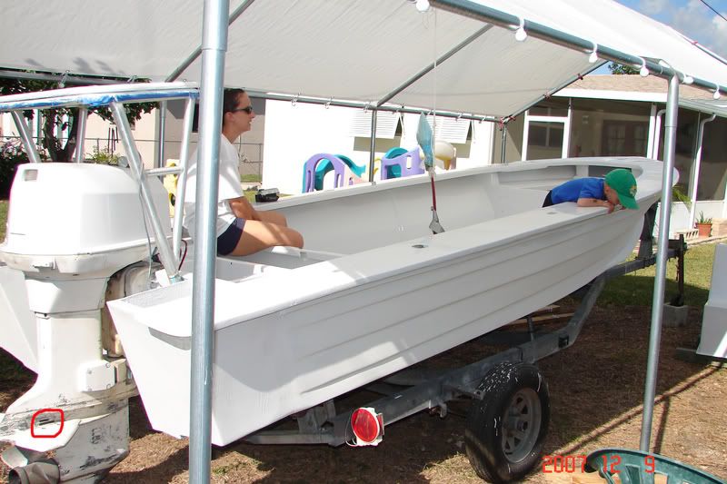

This is actually the ports i was wondering if water should come out of when running on the hose and the engine is warm. Not the upper exhaust holes. Here is a pic.
tashasdaddy
Nov 11, 2005
51,019
Re: 1987 Johnson 88SPL how do i know if thermostats are opening?
no unusal.
