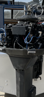

1987 Johnson/evinrude E110xcur. Wondering two things about this motor. From info I gathered it is supposed to have a belly pan. It does not. Curious about why it wouldn’t . I believe it was rebuilt and maybe is a modified motor now?
A issue I’m having is it started idling too high. It idles fine in gear but high in neutral. Would this be caused by cable stretch?

Hard to see but mine is flat.

That would be the outer exhaust housing.------Your power head may be a 90 HP version.----Or an older 115 HP ( powerhead rated ).-----It may involve a bit of machining if you are keen to install that.----Do those plug wires have a metal core?----And why are they so long ?
