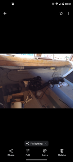

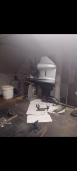

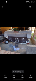

Small update. Been busy over the past few months. First season I got back into deer hunting since moving to NC, sold my old jon boat, lots of crappie fishing, and just started coursework for my phd yesterday. So progress is creeping along slowly and may be halted until march when it warms up. But, I got the gimbal housing all done up and installed along with the trim tabs and stuff. Also put my outdrive together!
Next step is to shop vac the bilge pretty well then drop the motor!
