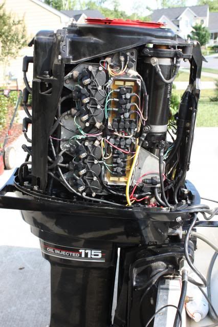

thanks to all who took time to reply. Local shop wanted 240 per switchbox plus 180 to install; I found a couple new ones on ebay for 99/each and installed myself. It's fixed - starts easier, much smoother, performs good from the moment it leaves the dock. tops out in mid-high forties at 5600rpm with myself & two daughters, cruises at 30 at around 3800rpm.
new ones here installed, right before start-up
