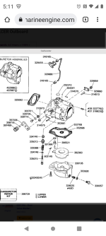

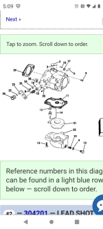

I still need to know if I have the wrong carbs installed. These are 2 different types of carbs the original carbs do not have an external needle valve adjustment and the the carbs installed do please help. Thanks. Tim
saltchuckmatt
Jul 19, 2019
3,171
The 88 does not have a idle needle and the 89 does according to the parts breakdown. Also, the 88 has a 49d main jet and the 89 has a 50.

Tim T.
Seaman
Dec 13, 2022
70
So my question is still not answered will the carbs with the external needle valve work on my 1988 48hp?
39,454
I think you need to trouble shoot this motor.----Post the compression numbers.----There is more to it than an adjustable idle mixture on a carburetor!----Sounds to me the 89 carburetors did not fix the issue.-----Then you became the proud owner !!

I think your showing the wrong carb unless I'm going crazy. 🤨
The top carb I posted is his 89 and it has the side mount idle screw.
