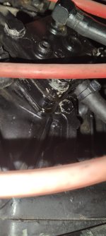

I assume you mean the fuel pump mounted on the outboard...not the hand pump off the fuel tank.
Just found this! Looks like this could have potential? This is the fuel pump sending block thing on the side of the motor.

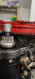

This is what I have. I assume that the pointer goes on the right side of the starter.

Honestly, haven't checked the one on the side of the outboard. Assumed since I Had fuel in the bowls it was working. Even without it working wouldn't it run at least for a few seconds?
Mine didn't run...if I remember correctly, I read that it pumps thru the filter/ to the carb...but under full throttle also pushes fuel directly into cylinder #1.

The timing pointer is #17. It looks like it bolts to the spot next to the starter. You should set the motor to TDC with a screwdriver and see if the TDC mark is in that area. it should be obvious if it is correct, as off 1 spot is 45* out of time.
