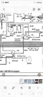

I need a diagram of the wiring for the solenoids . It is three solenoid’s. I am not very good at electronics so I need a picture or diagram. I believe that someone switched motors and didn’t hook everything up.

Ayuh,.... Welcome Aboard,.... Which solenoids, for what,..??

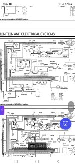

I hope this helps you, the first is basically the overall diagram and the second is a closeup of the area I believe you are talking about.

I am getting power to the solenoid and it just clicks. Does that mean it’s bad or am I not getting enough power to it?

Ayuh,...... Welcome Aboard,..... To rule out the possibilities, make sure the battery is fully charged, that both ends of both cables are well cleaned, as well as the solenoid wiring,....
