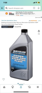

What type of hydraulic fluid would you guys recommend for the stern drive motor?
52,357
Tkilkenny
Seaman
Jul 21, 2023
56
I was meaning the hydraulic fluid pump that runs the stern drive up and down. We have had it put on the water two days strait. Running amazing
52,357
yes. and the power steering fluid as well
just an FYI, most 80's motors used SAE 30 in the motor, power steering, trim, and in some cases the outdrive.

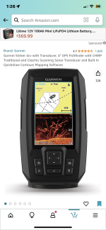

Ok I will look in the Manual. I put w30 in engine and a high viscosity in the drive. Steering is mechanical. Just need to check hydraulic pump fluid. Greased the mechanical steering rod. If I recall the drive have a zerk I can grease. Any other spots? I have a new blower coming since the one I have is slightly wrapped and screeching unless I move it a bit by hand. I want to get a fish/depth finder. Any recommendations? This is the one I’m looking at nothing to fancy.

Either one?

Not knowing what is in there, hard to say, but I always used Dex from the auto parts store
