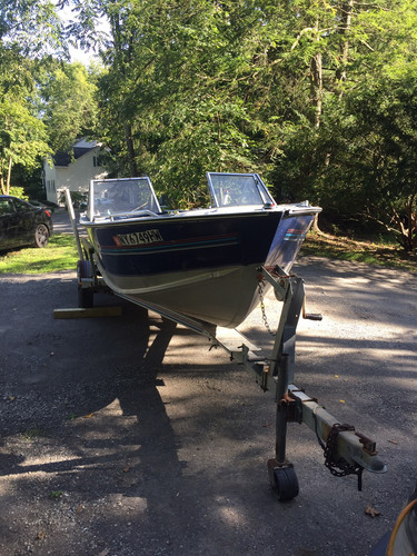

I am the new owner of this 1988 bluefin sportsman. Owner said the floor was replaced recently.
I put water in it and noticed a very small drip from a rear rivet under the middle trailer roller. Should I be alarmed?
It has barnacle's on the bottom, how can they be removed? I plan on doing a light reno on the boat if the small drip can be fixed.

Maybe I was too basic. I know from research rivets can be sealed from inside with Gluvit and outside with jb weld. I can try that.
Would more pictures help? Barnacle's can be removed with any Lime calcium cleaner. I see a few on the market.
What do these bring in value?
53,296
re-buck the rivet with two people and two hammers

yes, re-bucking is as simple as holding a big hammer on one end and using a smaller hammer on the other end to smack it.
however a re-bucking tool would be used to protect the shape of the head of the rivet. usually a small leak doesnt need too much to get it to stop.
