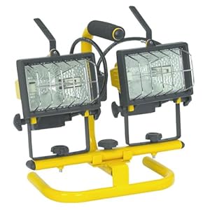

Halogens,
and this little unit from HF
and I think you could keep on glassin even with all that White stuff. As long as the substrate is @ 65? and kept there till the resin kicks and for an hour afterwards then you should be good to go. The resin won't know it's FAKE heat. It'll think it's Spring Time!!!! Use the heater ( it really works great for spot heating) to get the panel up to temp then use the Halogens to keep it there during cure.

Halogens,
Ive been using a small 3 speed electric droid, set on the counter facing with workpiece. What Ive been doing is I turn on the heater and set the resin bottles by it to warm it, i also mix the resin in front of the heat. I heat the workpiece with the heat gun to warm it, then set the 1st lam. I coat that with resin and hit it with the heat gun till it get real thin and hot, it actually flows around from the gun pressure and saturates the cloth. Then I just throw the other 2 lams in the hot mix, and they melt right in with little effort. I leave the heater on it for a while to help it set. I need a set of those halogens tho...they looks like it would work better than the heater.
As soon as this deep freeze passes, im gonna try this on the stringers...maybe the halogens under the boat facing up to the stringer area will heat the hull bottom...

Another trick is to heat some water and pour it in a large pot and set the resin in the pot to warm it. If the resin and the substrate are @ temp for 2-3 hours with epoxy then you're good to go. Two 500 watt Halogens will put out a lot of heat if they're up close and personal to the surface. I'm just passing on what I learned from OOPS. He was a Canuk and he had all the tricks for working in the Cold!!!!
