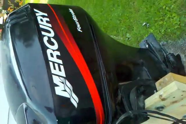

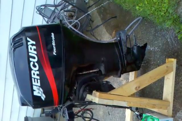

I'm thinking about what all I need to do to get the engine back to life. It hasn't been run in a long time. It sat in a shed for about 7 years, and sat outside for about 6 months after that, but was straight upright the entire time. It is a 2001 mercury 40 hp 4-stroke, it is the carbed, 3-cylinder one. I already used a wrench to turn it over once to confirm that it wasn't seized up.

I fired up the engine this weekend. It sputtered a bit at first, but is running reasonably smoothly. I'm posting a couple short videos of it running.
Here it is idling after a couple minutes of warming up, it took me a bit to get ready for filming.
Here I rev it a bit.
and here it is idling after warming up for about 15 minutes.
Hear anything to be concerned about? It sounded pretty good to me. Every now and then there is a very slight pop/clunk sound, but only about every 4-10 seconds or so. You should be able to hear it early on in the last video.
