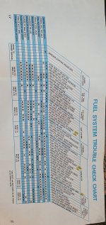

Thanks Faztbullet I invested quite a bit of time to remove all the freeplay from the linkages and ensured they were both fully closed and opening at the same time. I came out this morning to start the head scratching again and there was a puddle of black sooty oil on the ground under the leg. I am going to work through the evinrude manual fuel system trouble check chart and see if i uncover anything.
