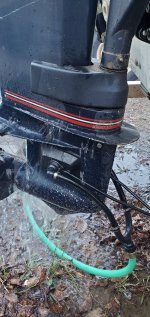

Hello, I test ran my motor today and noticed water spraying out between the lower unit and main motor. I don't recall seeing this on my other motors. Bad seal? Bolts not tight? Might be tough to see, but directly under the red striping. 20240509_193525.jpg

Is it coming out the telltale? Overheating? Then no, it will work.
It's just not mating up nicely anymore. A little tiny bit of flat filling will probably cure it.

Yes. It's not a strong stream though, figured it needs a new impeller kit.
