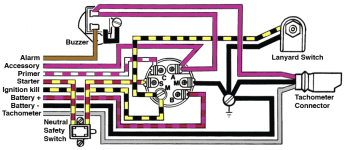

OK I have been fiddling with the Ignition switch all day...
Yellow black wire continuity from dash to motor plug end good.
m to M good continuity to ground in off position/ run switches to no continuity
m to kill switch lead 1
second lead to Yellow black from switch (double spade connect)
all continuity checks show everything working as intended Grounded or Open
Ignition switch off yellow black at the motor power pack connection good continuity to ground.
Run it is open
turn switch on wait for beep let run 30 seconds switch to off motor continues to run until I adjust idle to stall.
doesn't seem to want to ground out and stop.
I'm using this schematic
So looks like the power pack? assuming I wired correctly

If the ignition shuts off when you ground the yellow/black kill circuit wire from the power pack to ground it is an issue in your wiring harness or ignition key that is in the boat.
If the engine keeps running after grounding kill circuit wire to ground, you have a bad power pack.

While the engine running.
If you took a jumper and plugged in the black/yellow wire bullet connector tied to the power pack and you short it to ground, if the ignition does not shut off when held to ground, you have a bad power pack.
There is no further need to investigate the kill circuit for doing this.
What you DO need to check after identifying the power pack as defective, is make 100% sure there is no voltage present on the black/yellow wire on the wiring harness when turning the ignition key to any position.
You've already done most of the tests of the ignition kill switch wire anyways.
If voltage is sent to the black/yellow kill circuit wire, it will fry a power pack. It may not spark at all or it could not shut off spark. All it takes is one time to touch 12 volts on that kill circuit wire to cook it.

Got one more quick question...
The double purple wires that run from the switch to the buzzer...
Can I add another ring terminal and wire to this circuit and run it to an LED light to serve as a visual cue to an overheat issue (Old age loosing hearing and sight lol)
I tried catching voltage on this circuit but the buzzer just isn't long enough for my meter to pick up anything more than a couple Mv reading...
Just wondering if it is a good 12v source for the alarm that can handle a couple milliamps to light an LED.

in case anyone else needed the answer...
I discovered the Overheat thermistors operate as a grounding signal.
At the ignition switch the buzzer has power when in run or start via purple wires.
The brown wire completes a ground on the buzzer via the overheat senders on the brown wire at the remote on the buzzer.
