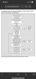

Run through the diagnostic flow chart before you start throwing parts at it.
