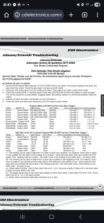

Hey all. Having problems testing for correct issue on this motor. I've looked up what I believe is the correct page in the CDI manual (screen shot included), but none of the wire colors seem to match up. I have also checked wire color verses pictures of original parts from parts manual and my wire colors do look correct.

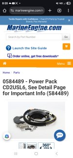

Power pack calls for part# 584489 but I have part#583656. My wire colors are:
Orange/blue stripe
Orange/green stripe
Tan (brown?)
Black
Black/yellow stripe

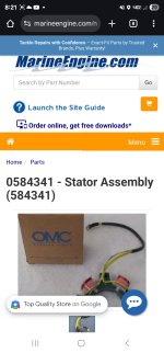

Stator part number calls for 584341. I have not removed mine, but didn't see a part number anywhere on it. My wire colors are:
Yellow
Yellow/gray(white?) stripe
Yellow/blue stripe

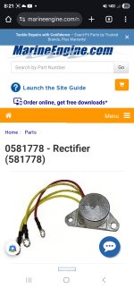

Rectifier calls for part # 581778. Wire colors are:
Yellow
Red
Yellow/blue spark.
If anyone can help on this, I woukd really appreciate it. I will add some pictures for reference.

And yes, I have unhooked the black/yellow stripe (kill switch) wire unhooked.

Agree. But where do I find correct resistance readings for my specific unit. it seems what I found on CDI manual doesn't line up with my wire colors unless I am completely misunderstanding...

I was saying they look correct when compared to pictures of OEM parts off marineengine.com parts manual. But they do not line up with the colors listed in the CDI manual that I posted a screenshot of.
Continuity test on wires should come out with 0 resistance. Resistants for your stator coil will be listed online.
If you mean online as far as the CDI manual, I've got that, but not the same wire colors I am seeing as I posted in pictures.
All the ignition systems can be tested but the power pack. If all else is good, then it's bad but you have 2 so less likely.
I thought CDI was indicating that power pack could be tested. The smaller power pack plugs into the bigger power pack with no wires leading elsewhere. Figured this out after pulling flywheel and removing all components to find the brown and brown/yellow under that smaller pack. was able to test those and came up with correct resistance (500-650 ohms) according to CDI manual. I cannot find the 'trigger' wires though. CDI calls for a black/white and white/black wire - but I do not see those anywhere coming from any component coming from under the flywheel.
