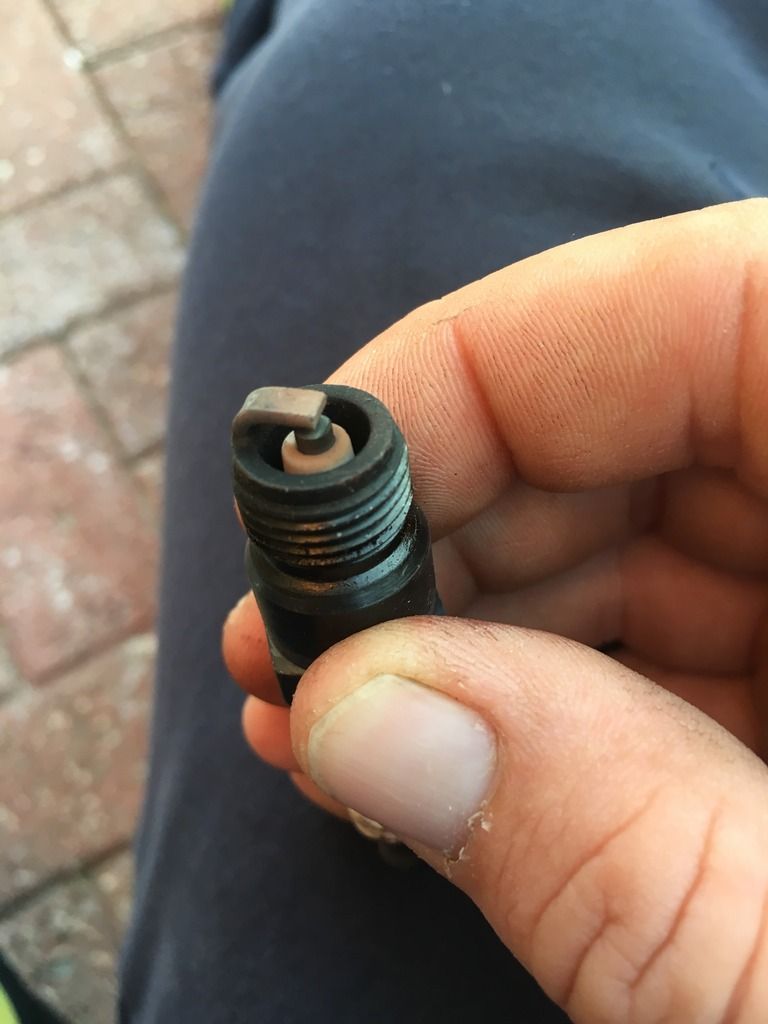

I don't think the plugs are very old they have a bit of golden brown mostly normal insulator white colour no discoloration

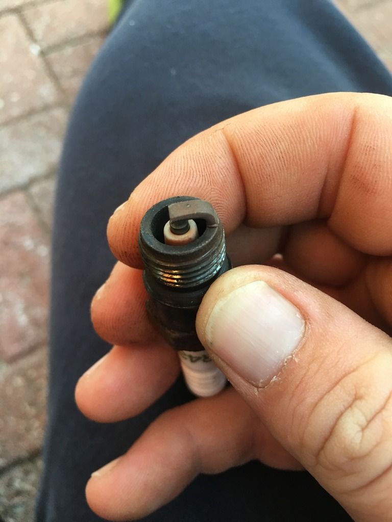

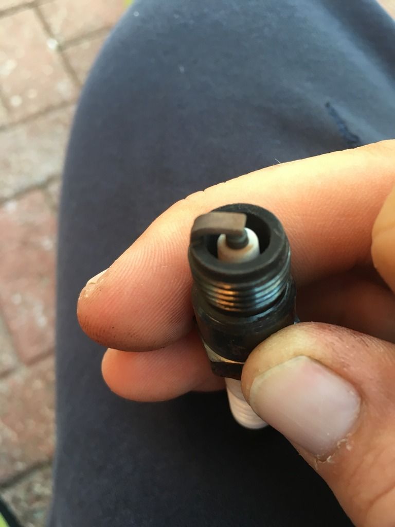

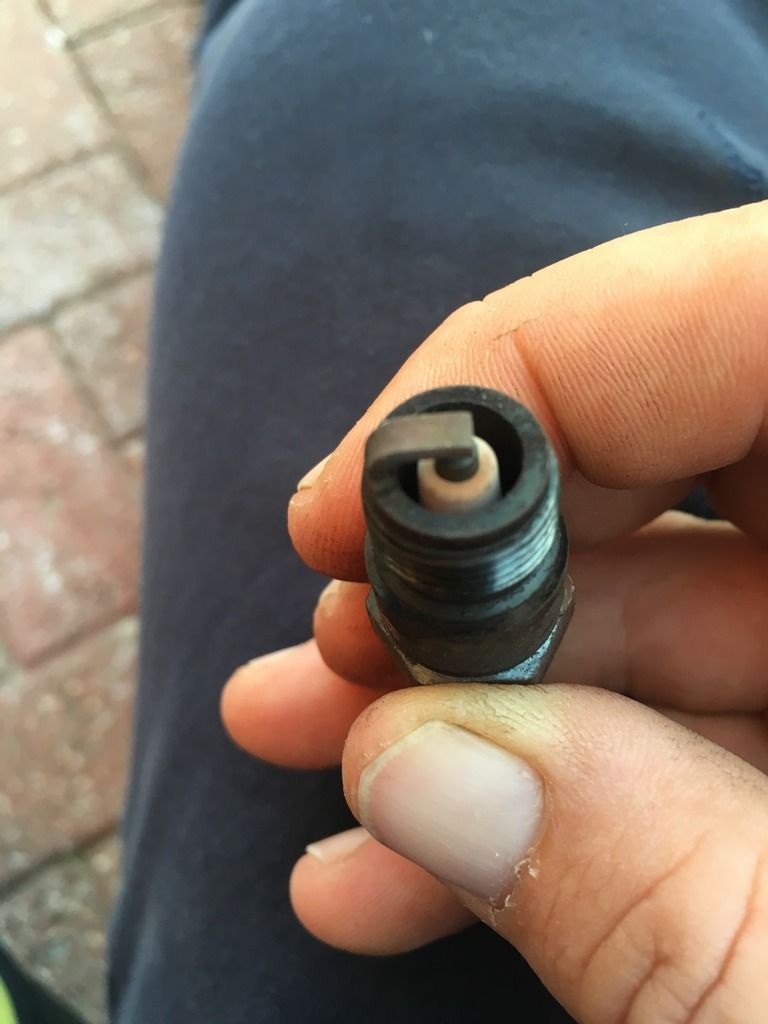

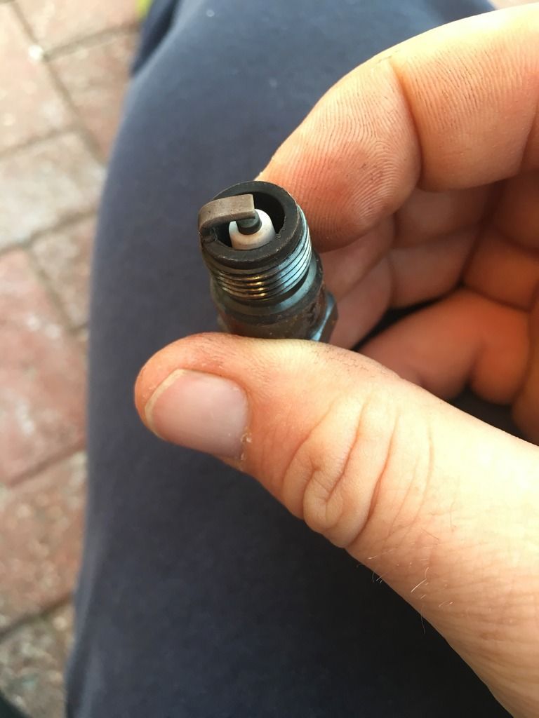

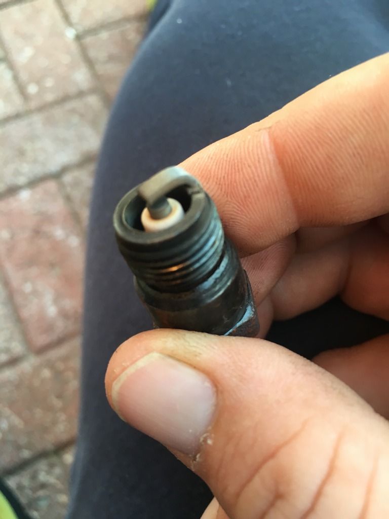

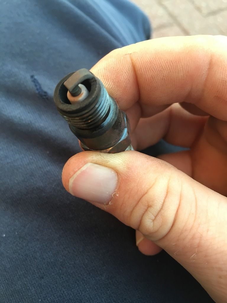

I'll snap pics of all 8 plugs and you guys can tell me what you think
