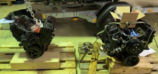

Hello,
I am just about to finish such a swap.
My original engine is from 1993, so no Vortec heads. The new engine is just factory new with Vortec heads, balancer shaft and roller rocker arms.
So I can tell you the difference between new and 1993.
Balancer - same
Flywheel - same
Flywheel cover same
Exhaust manifold - same
Starter - same
Oil dipstik is different but old one could be used
Old circulating water pump does not fit on the new engine
Intake manifold does not fit. The old one has less bolts
The new one has this serpentine belt and the alternator on the other side when it is built by facory. But all the holes and threads to mount the brackets the old way are there. THe only issue is that GM seems to have randomly mixed metric and imperial threads. So the flywheel cover, engine mounts and starter are metric. The water pump is imperial.
So what needs to come new is only the water pump.
Old water pump is in the back
So the flange with 3 holes does not fit here on the new engine.
The old engine looks different
New oil dipstick with drain hose
Old version
The new dipstick hose is much to high and I will have to cut it and also the dipstick so I can close my engine cover.
The new engine also has a coolant drain thread only on starboard side. the one new to the oil filter is missing. The old engine had one on both sides.

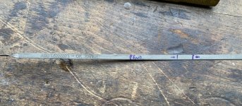

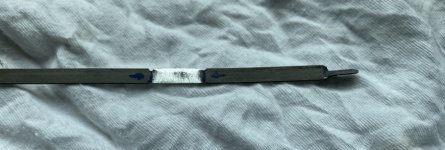

As it is easier to do as long as the engine is outside the boat, I decided to cut the hose today.
I found the mark hard to see already on the old dipstick and so I cut some gaps into it which made it much easier for me to see the level area.
So I will just do that on the new one too.
I cut of about 11 cm.
Then I used the cut off hose as a measuer for the stick, plus the thickness of the cutting disc.
Cut it, twist the edge, cut the marks ... done.
