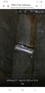

Let me shoot a video of my spark show the flywheel. It might give some insight

Did this picture go through?

Yes all looks ok and if the magnets were in bad condition you wouldn't get a spark to both cylinders so as the post before said are you sure you seated the flywheel correctly its sited with no movement (rocking) and tightly fitted to the correct torque i believe on your engine its 40 - 45 lbs

Fly wheel is on their good. No rocking and properly seated. Torqued with my wrench

With the flywheel in place without the locking nut you should see the woodruff/flywheel key engadged tightly into the slot on the flywheel yours looks flat at the top and broken and protruding at the bottom of the crankshaft
