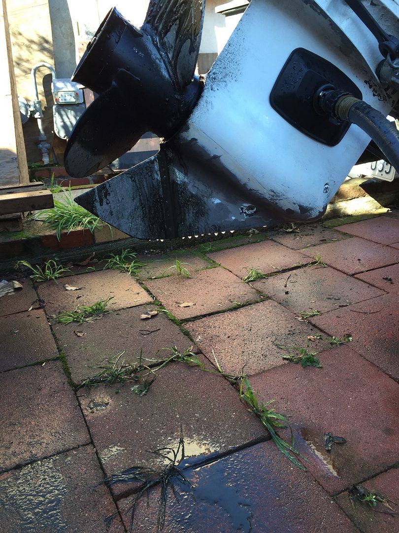

Trying to figure out if this motor is indeed a 1990. There are is serial number plate. Was told it was a 1990 but the mechanic isnt too trustworthy ,im thinking, hopefully I'm wrong. Here is some pics below.
The problems im having: All the oil came out the lower unit from behind the prop area when trying to diagnose a starting problem in my driveway. Luckily not in the water.
I immediately turned it off and have not messed with it since. My buddy is pushing me to get it going and I wouldnt mind at least figuring the issue out.

Regarding the oil problem. I mean ALL the oil came out it was just kinda flowing. Have the prop shaft / bearing carrier loose , gonna replace the seals and
o-ring with lower unit seal kit coming in the mail. Hopefully that should seal it n keep it sealed!
