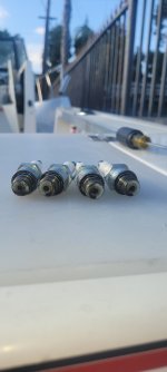

Another picture of the plugs.
Do it ran great for awhile and then it suddenly stopped, it would stary right up but sometimes there was a bit of backfire when cranking. I did start it a few 10 times and it seems to be ok now. I was like wtf this is new. So I raised the front of the boat more and it worked fine. Lowered it again and it did not do it. I took off the hose from the tank to the first junction and trimmed the ends. I took off the fuel sender and looked in the tank there is fuel there. It shows quarter tank on the gauge.

I took compression again today and I had 150psi on 2 and 145psi on other 2. Safe to say the exhaust fix help raise it up at least on the test results. I have to take it to the lake again. I really hope thatit doesn't die in gear anymore. The fuel line is mostly new. Pump new, all gakets new clams everywhere. So of it still dies it will have to be electrical.
I actually tested spark with a special tool and it showed spark at 7/16 and close to half. I mean it sparked, could not tell if it was strong or not. But the stator and trigger are new from CDI. The coils and modules are working fine on the other engine. Batteries are great. Reeds look new stainless type. Hope that it will work.
