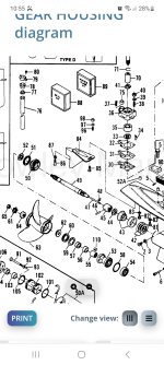

As far as the prop being too tight, I just removed the prop shaft and main shaft and as I mentioned above I removed one of the spacers that go between the cluch and the front gear. There were two there. The shaft was hard to turn when I tightened the retainer but after removing one of the spacers it was exactly the same as the shaft on the other engine.
I am including a picture of the diagram,
the spacer is number 44.

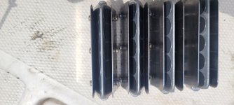

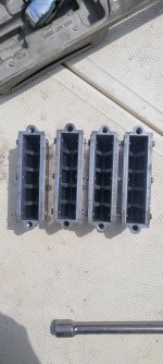

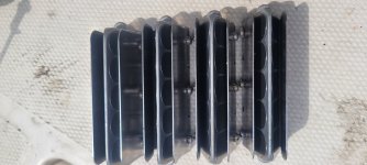

I took out the reeds and they are not the plastic ones. No light going through don't see cracks.
I also remived the fuel pump and the membrane shows a little tear. I ordered new gaskets and membrane for everything.

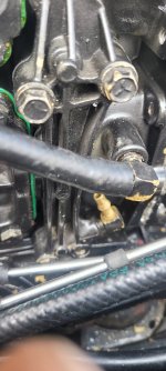

The elbow connector for tye cylinder drain cover was loose could turn it by hand. So I will have to remove it and tighten it.
I will change the hoses and add clamps. There are no clamps there, don't know if that makes a difference.

So as you can see above the reeds are stainless not plastic. They look new. I am waiting for the gaskets to put it all back. As I said the membrane on the fuel pump had a little scratch looking mark along the circular line. It was showing only on one side of the membrane not the back. So, I ordered another one since I don't think there should be any marks. I am also waiting for that. I sure hope I find the reason I get this dying in gear issue, but it has to be a fuel supply problem?! The lower drive is not tight anymore.

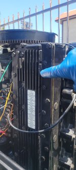

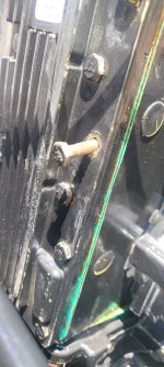

So when I rebuilt the engine I changed the gaskets. Here are pics of some of the bolts from the exhaust cover. One in particular is rusted all the way in. I am sure I cleaned it when I put it in. I did not use any sealant on the bolts though.

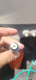

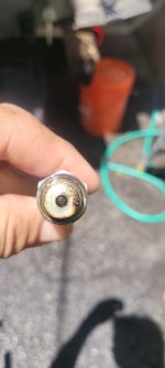

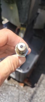

Here is a picture of the spark plugs after usage. The problem engine plugs are pretty clean with a drop of black fuel/oil mix. I don't even know if that drop is oil or water. The other engine plugs look different.

I just sprayed carb cleaner on the 2nd engine exhaust cover and it also dies. Must be normal. Still the plugs are too clean on the problem engine.

Clean plugs maybe is a sign of water intrusion.
Check the head gasket, looks like it is okey from the compression numbers but there are also a chance it will have water intrusion from the exhaust side.
Leakage at the gaskets at the exhaust cover can also cause water intrusion to the cylinders.

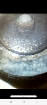

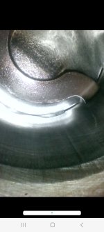

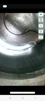

I just took a picture of the #2, 3 and #4 cylinders with an endoscope cam. #2 and #3 look dry #4 looks wet that is not normal right? Even thoigh it's the bottom and everything reponds to gavity.
I am taking off the exhaust cover. Should I take the head off also. I did get good compression at 140 and 135?
