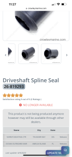

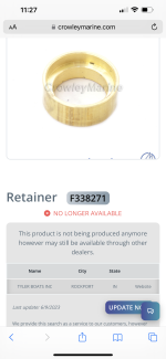

Hey anyone have any photos or vids on how to install spline seal and keeper at top of driveshaft ? Mine was floating around in the motor

Don't have any vids or pics.....basically slide the retainer down on the driveshaft with the cupped side up, then slide the seal down onto the retainer where it seats into it. Then install the lower as usual.....tricky part is not hitting the sides and knocking the seal off before it engages. May take a few attempts to get it. Wouldn't hurt to apply some marine grease on the splines...just don't put any on the top of the driveshaft.

when I took the lower and seen the drive shaft it had no boot or keeper , but the splines looked “knicked” further inspection I looked inside and seen the rubber boot look at me just hanging out in there , but no sign or the copper ring
Have heard some folks don't even bother using the seal and retainer.....will run fine without them. If you have the parts I would use them....they are supposed to be on there. No telling where the copper ring is, may not have been installed by the PO. Might be why the seal was laying there looking at you. Or it fell off during installation.
