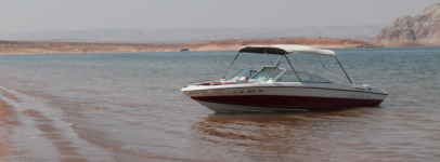

Pictured is our beloved boat at Lake Powell (lucky we got to experience it before it started drying up). I'll be sure to add pictures as we begin the deck restoration process!
