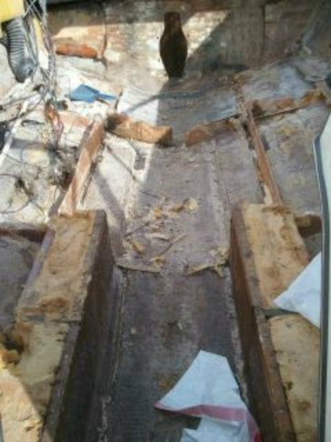

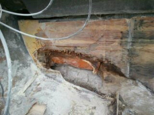

The transom wood went all the way to the side of the boat, but was filled with foam behind the sides.

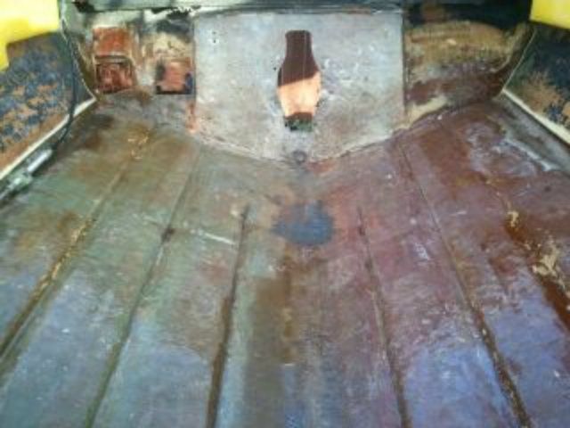

The hull at the transom has a tunnel shape. I was considering rebuilding my transom similar to Frisco's Glastron and not go all the way out so I can tab to this tunnel. This pic may not be the best for showing it

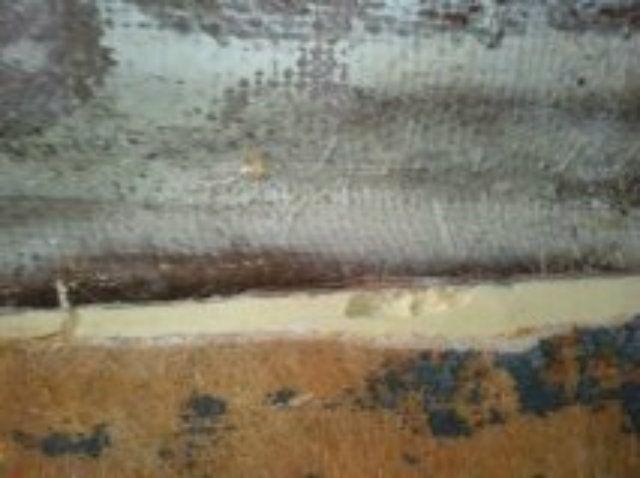

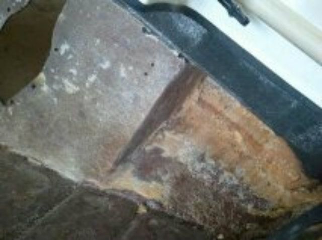

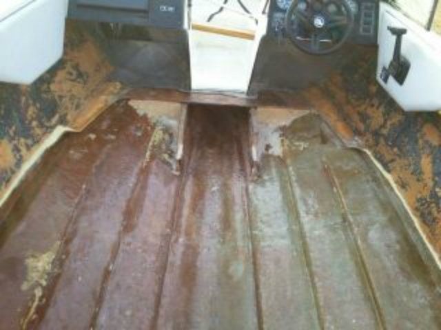

I found dry wood under the consoles at the ski locker. I am planning on tying my new stringers in here so I don't have to pull the cap. On the gunwales I have a foam with fiberglass liner of some sort. Not sure if I should take it out completely or cut out just enough to tab in my deck. Does anyone think this provides anything structural?

I took a couple of photos of the two areas I'm stuck at. Trying to decide how much more demo work needs to be done before I can start rebuilding. The bottom is the foam sandwiched between fiberglass on my gunwales.
