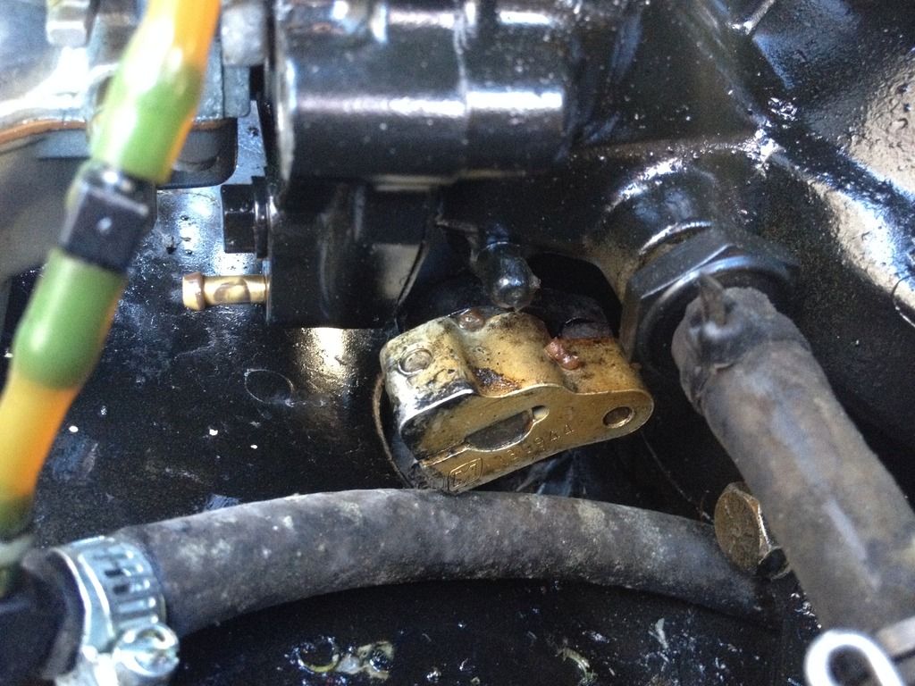

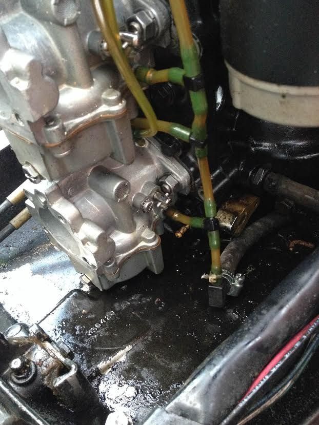

I recently acquired a boat with a 1990 Johnson 60 HP Pro Series motor on it. This outboard originally came with a VRO setup which was removed at some point prior to me purchasing the boat. I got the motor to fire over today with starting fluid but it appears that the carbs aren't getting any fuel to them at all. I suspect the shoddy job done in removing the VRO pump is at fault.
I don't have a tank for the boat yet so I had the fuel hose in a gas jug full of premix gas. I figured with the electric fuel pump it should pick it up.
Can someone please check these pics and let me know what I need to do to fix this mess?

Normal method for disabling the VRO is to use the appx 1975 era engine's fuel pump... or just plug off the oil side of the VRO pump and disconnect the oil alarm.
No idea what pump you have there... But first step in testing it is to disconnect it from the carbs, run fuel line back to the supply tank (or a catch can)and turn it on. See if it actually pumps at all..
Then you have to find out how much fuel it can pump vs what the engine requires.
If its not supplying enough then with the setup you have there, the top carb will starve first which would result in catastrophic engine failure.

I cracked the fuel fitting open slightly while the fuel pump was running and there was fuel at the motor. It doesn't seem like it's getting from that point over to the carbs. it also looks funny the way the previous owner deleted the VRO in comparison to the ways i've seen in other photos.

AK and racerone, thanks for the ideas, unfortunately I don't believe my motor has the same mounting option as yours does. I checked it and didn't find any unused mounting holes or anything. I think that I will have to use a fuel pump similar to yours except that it will have a 3rd hose connection for pulse air from the crankcase. I'm just unsure of where to get the pulse air from. In the picture I posted does it look like the pulse air would come from the brass nipple?

I would assume that hose that is capped off that used to supply the vro system with vacuum would be sufficient. oh and that pump looks like it will work as well. when ive looked up alternative pumps like this one the spec ranges from 6hp to 225hp.
39,806
The brass nipple on the bottom of the intake manifold is not to be used for a fuel pump !
AKJETB
Feb 2, 2016
6
i am not referring to the one that goes to the intake i am referring to the one that has a screw in the hose. you can see it in his pics one page 1. that was the vacuum source for the vro fuel pump correct? so would that not be a sufficent source source for a fuel pump?
