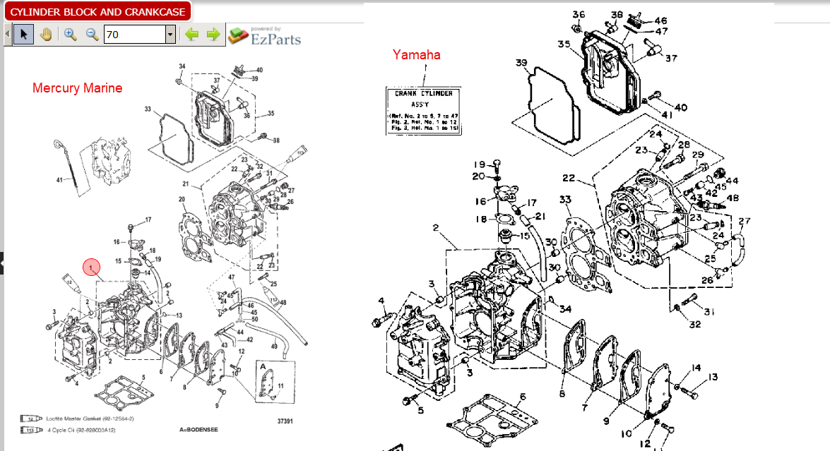

I see no way to cross over the part numbers from Mercury to Yamaha, but the aftermarket listings show confilicting information. Apparently the power head won't swap but the head may?
Again I'm being told that the head on the 1990 Yamaha is a 1988-1994 year span,
I have a 2001 here, and that head is very different, but is the 1996 mariner and the 1990 Yamaha the same head? The dealer says no, aftermarket listings show two different gaskets. I have both in hand,
6G8-11181-A0-00
6G8-11181-A1-00
Both gaskets in hand look identical, they're the same thickness and have the same size holes.
Five dealers told me that the two motors are not at all compatible but they look identical other than color. One dealer swore up and down that the power head was Mercury built.
What years were the same when it came to the power heads with Yamaha?
The Mariner head will bolt up, the head gaskets look identical. The pistons look identical, as does the entire rest of the motor. (Even the hoods will swap, they appear to use the same pan) but the lower units are obviously different.

Yamaha made motors or power plants for Mercury/Mariner for a number of years.
See below. What do you think?
