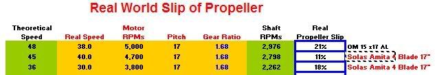

I show you should be using a 19" prop, but you are showing a 21% prop slip right now at WOT with the 17" prop and that is too high. So I am going to recommend a 17" pitch 4 blade in the Solas Amita and in my opinion it will bring your prop slip down enough to make your top speed reach 40 MPH and also dramatically increase your hole shot and acceleration at all RPM to WOT and should turn about 4,700 RPM. Here are my postulations for your old and new Numbers and prop slip.
Prop Slip

Duke, do me a favor before you order the prop, put the old prop on and rerun it again to make sure the RPM didn't increase another 1,000 RPM. There is no way that the 19" should have gone to 6,000 RPM and the 17" only 5,000. The Smart Tabs shouldn't have increased the RPM anywhere near that much, as I have installed them on my boat a long time ago myself.
Please send me a picture of the 19" prop installed on the boat.

Sorry I never posted results! My top speed at WOT with this config was 43 mph at 5000 rpm, too much throttle! The solas amita 4-blades are everything they say they are. Hole shot was ridiculous and with the smarttabs, I'm on plane at about 11mph. It just bobs up, and out, and I'm on top.
