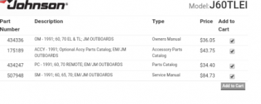

I was going to download one online but it was for just a Johnson like 10 year range not necessarily my model I guess I need to keep looking around to find the exact one. Even if I had a manual I still wouldn't know what to check but I realized it would tell me what the ohms ranges should be. Do the manuals usually have troubleshooting for completely no spark and does it show you the process of finding what's wrong?

Yes got to https://www.outboardbooks.com/ That is a factory manual save your money and do not buy seloc or clymer. One question is the safety lanyard on?
