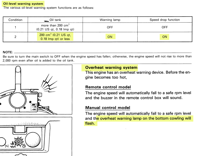

halsteadmorris
Mar 10, 2021
41
The folks over at Crowley Marine were able to get it answered. Makes sense, as there was no water running through it at the time. Posting this in hopes that it helps someone in the future. Thanks all
It won't. Actually, it may send someone down the rabbit hole. Not all Yams are alike. Yours may be completely different from the next fellows Yam.

Don't mind the peanut gallery. Your information will absolutely help somebody.
