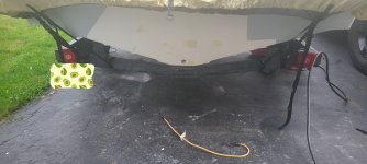

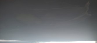

Transom done. Boat sanded, so much sanding wow, weeks of sanding! Almost ready to get these on. Just waiting for some cooler weather.20210818_173400.jpg

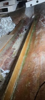

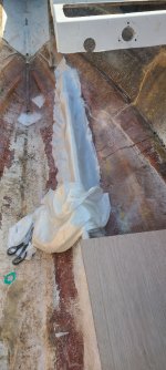

Finally got resin. And started the stringers. Peanut buttered'em in and added a layer of chop then 1708 then chop thus is midway through. Too hot to do anything during the day the resin hardens too fast.
