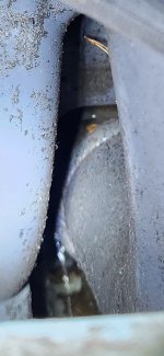

Just got back to the dock after a fun day, and heard trickling from the engine area. Found water trickling in from either the exhaust outlet, or just Just around it. Any thoughts on what it could be?

We cannot see what your seeing so we need pics and more explanation
Looking at exhaust outlet or just around it is a bit vague
53,268
First thoughts are not good....post pics
53,268
See if the water is coming in around the transom shield

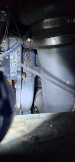

This is looking in from the port side.
Hard to get a camera in, a light, and take the photo.
The bottom centre has water trickling over the top of the horizontal part of the exhaust, and down into the bilge.

Now that I have had it home and gone over a bit better and not in a trailer parking spot - I found a .5inch slice in the top accordion bellow on the starboard side - and if I leave the boat in water and have the drive up, and turned starboard my leak almost stop...so think that's the guilty party.
Other things I have noticed that I will have to tackle when the drive is off, the trim sensor, and play find the hydraulic leak on the drive.
