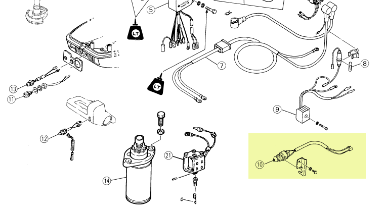

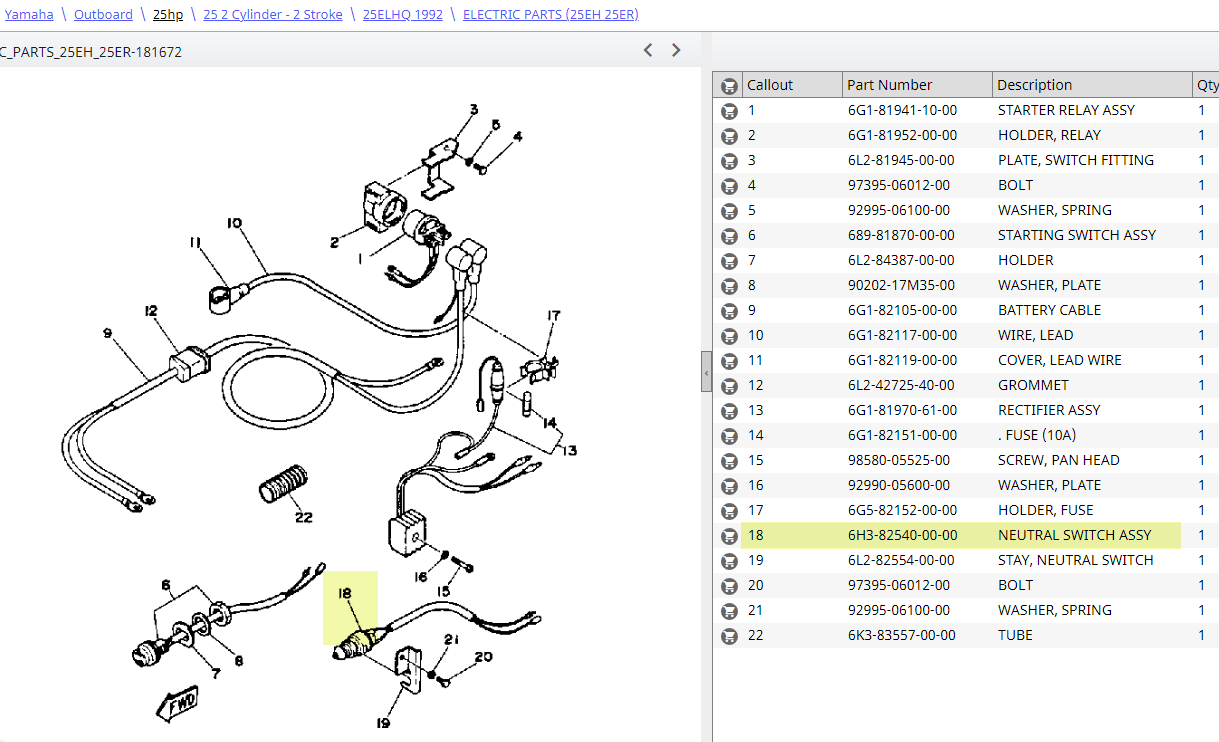

Almost done setting this up. Originally a control motor with oil injection and e start model number 25elrq. I noticed there is no neutral safety switch as that is handled in the remote control box. Right now it will start in gear so it's dangerous. I see on the parts diagram the neutral switch and a small bracket. Is there anything else I will need to make that function? I'm assuming the end of the switch interacts with the cam on the lever shift rod (the piece that is bolted to the lower cowling that rotates when shifting) any help is appreciated to keep this motor safe. Thank you

Can someone get me a picture of the neutral safety switch as installed on 2 stroke 25 hp. Like to see where the bracket mounts and what the switch makes contact with. Thank you

Anyone know if neutral safety switch bracket mounts where the threaded hole below that bolt is?
