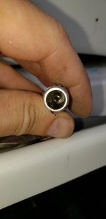

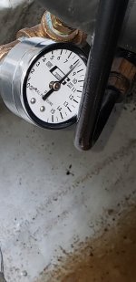

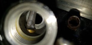

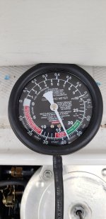

This morning I completed the following:
* checked anti-siphon -> it appears clean
* checked inlet to carburetor -> it appears to be clean
* installed a fuel pressure gauge -> fuel pressure is ~8-9psig through RPM range
* hooked up a vacuum gauge to the manifold ->vacuum is ~17-18 inHG

The pic of the anti siphon valve appears to show varnish build up. I don’t recognize that thing in your QJet fuel inlet and your fuel pressure seems too high.

With 9 psi (if the gauge is accurate) just maybe the carb is flooding. Did mention, hard to start, low power, stumbling
Andclyki
Jul 8, 2021
9
I assume the gauge pressure is accurate. I can double check with a second gauge. If 9psi is too high, would a regulator be needed?
alldodge
Mar 8, 2009
43,933
While some needle seats can take pressures above 7, the normal high is 7
Can be easy to see if the seat isn't holding. Look down the carb when its running and right after shutting off to see if you can see it dripping
Yes a regulator can be added

All, thanks for the troubleshooting help with this. I confirmed the fuel pressure was ~9psi and ordered a regulator. It is arriving today, and I'll get it swapped on tonight.
