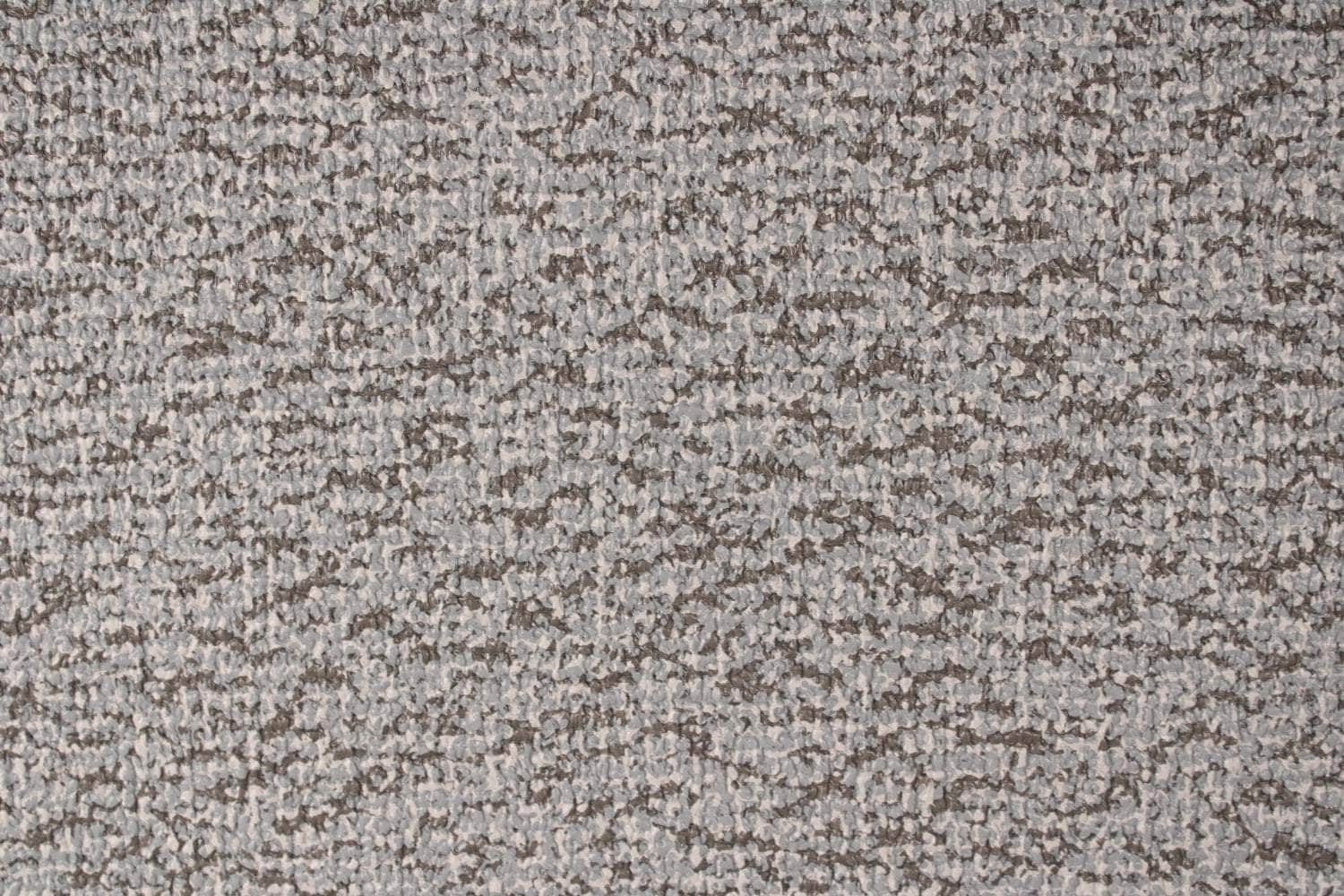

Floor is done, adding marine flooring with the 1/16 " pad.
Anyone use a product like this for the floor? If so what did you use for the edges?
Marideck Marine Flooring​
